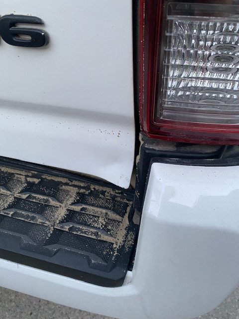

    Update: Toyota Canada has agreed to cover the paint and tailgate damage. Warranty manager was surprised that it's being covered. Damage isn't that bad but tailgate corner is dented and paint messed up. Repair estimate came to $800 Canadian.

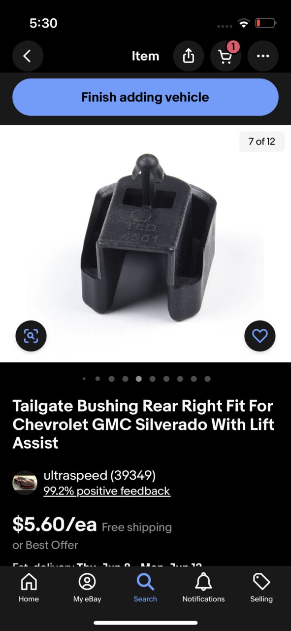

    Mine just did the same thing. It’s cheap enough($10?) and easy to replace. I just bought two so I could have a future backup

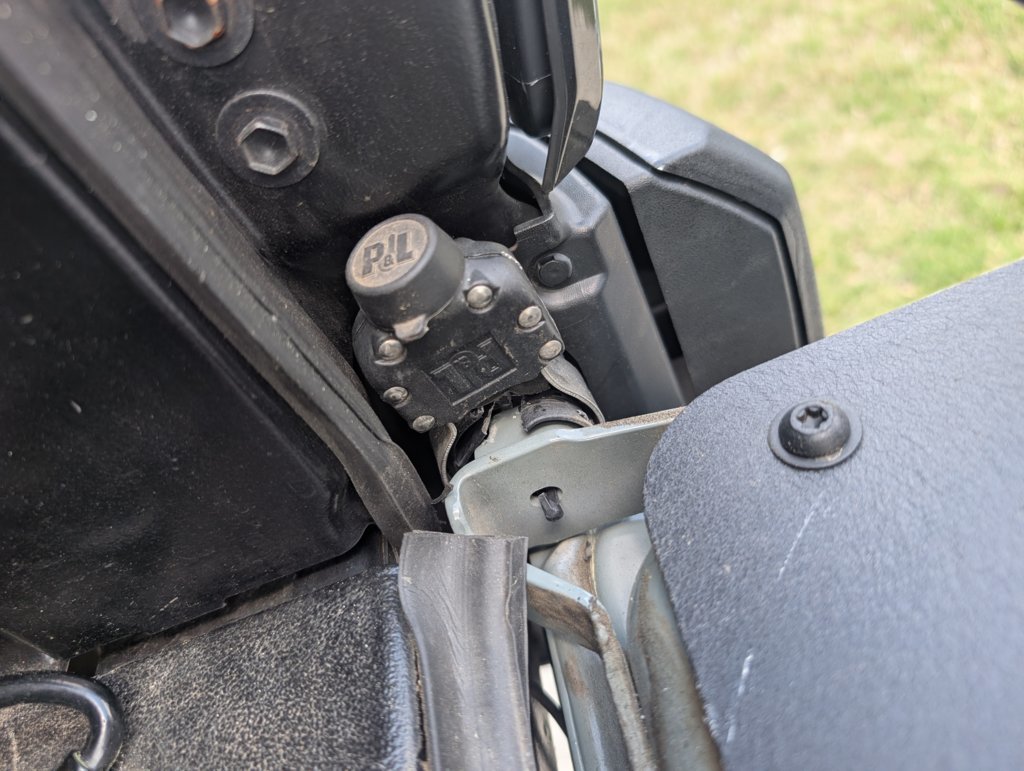

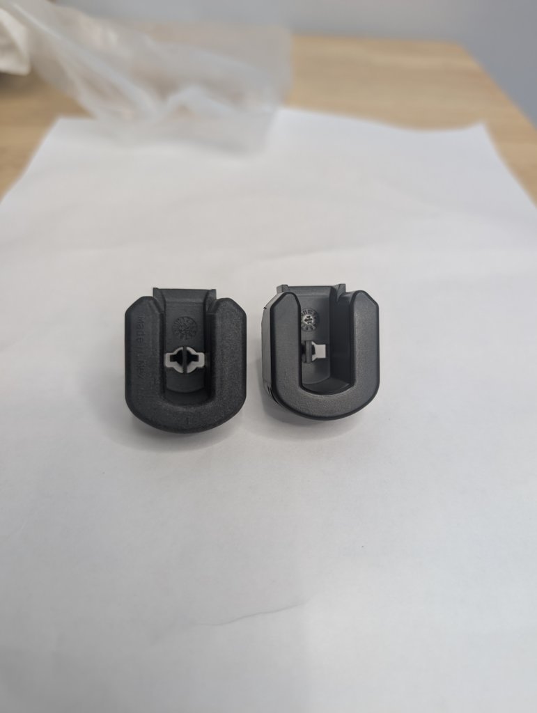

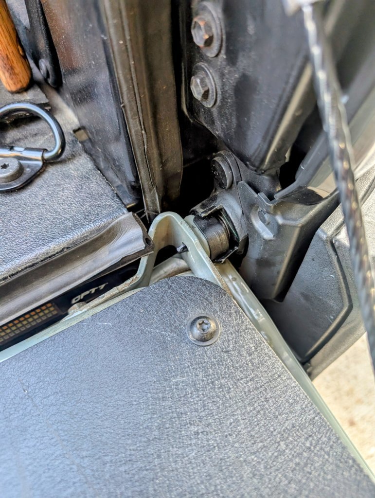

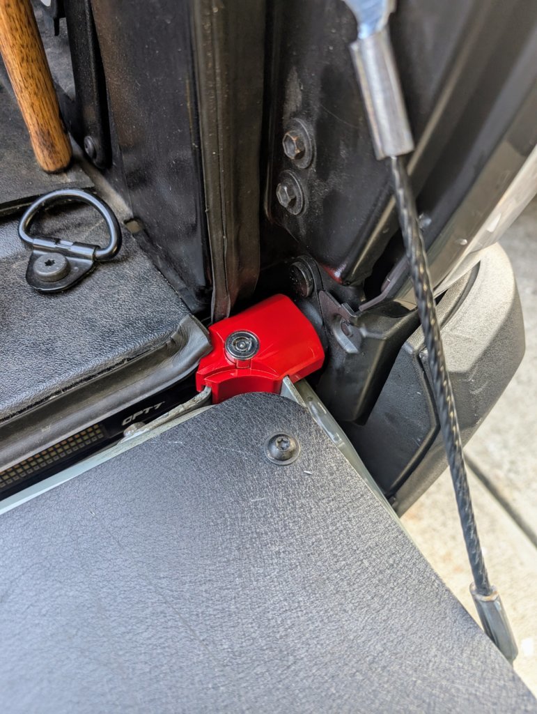

    Took me a few days but for good reason. I got my aftermarket ones I ordered the next day and when I held them they felt cheap and plastic quality was subpar to say the least but I still tried it and installed it. The tailgate would drop hard the first 1/3 and then the assist would pick up but it wasn't as smooth as the OEM part so I ended up going to the Toyota parts website and ordered one to pick up at a nearby dealer.
    Left: OEM
    Right: Aftermarket
    You can see in the aftermarket one that it looks way more glossy and the walls of the part are notably thinner not to mention the U space opening is significantly wider compared to the OEM one giving the tailgate a less smooth and worse drop feeling.
    As soon as I installed the OEM one and gave it a go it felt like it did before.
    Bonus for me I installed a better looking hinge lock too while I was at it.
