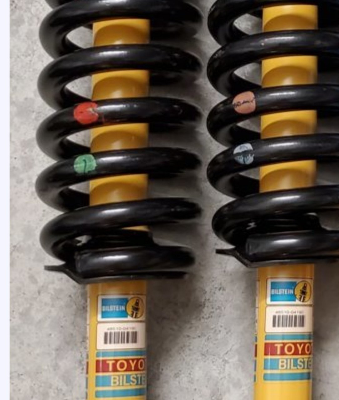

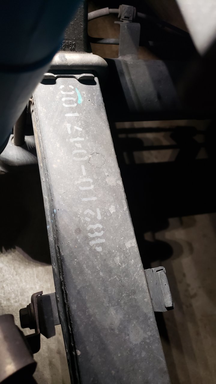

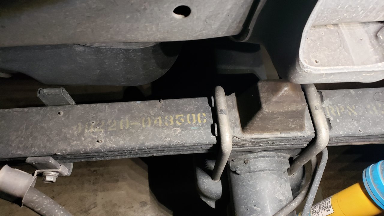

    Can you guys look at your leaf packs and look at the color of the part number. mine has yellow on driver side and white on passenger side w no lean.20200712_145211.jpg 20200712_145152.jpg
    Maybe the factory mixed up the leaf packs.
    The same w the coils there is a driver specific color on them.
    Driver red dot, Pass pink dot, thats how they are on mine.20200717_215046.jpg
