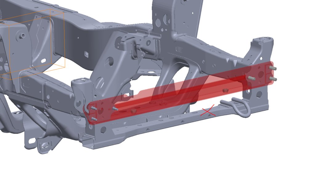

    I have only heard of c4 , coastal , an warfab for making crossmember deletes.
    As for rigidity I think c4's bolt in member is a little janky, the ones that are welded in like warfab and the one I designed below are much stronger and more rigid than stock.
    As for 3rd gen bumper on 2nd I do think the skid and crossmember would work but the bumper wont most likely. 3rd gen bumpers accommodate the grill that comes much more forward.
    This is just my $0.02, I have not tried any of this yet.

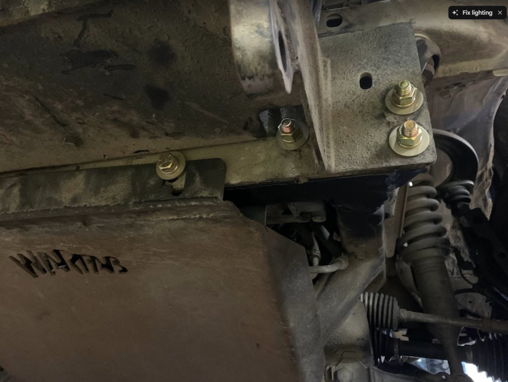

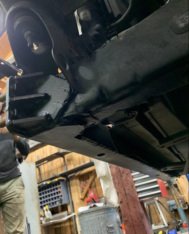

  12. Sep 9, 2024 at 7:03 AM
    TacoTuesday603
    TacoTuesday603 I welded it helded
    May 3, 2021
    #364592
    3,378
    Jack
    New Hampshire
    2011 OR DCFB
    Fox and Locked suspension 63's Skinny 33's
    Installed my setup this weekend on a friends truck. Ignore the skid setup, its pretty mangled and warfab makes it mount wierd
