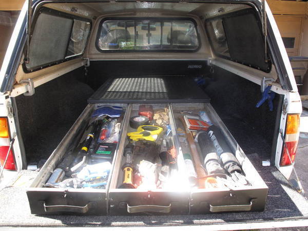

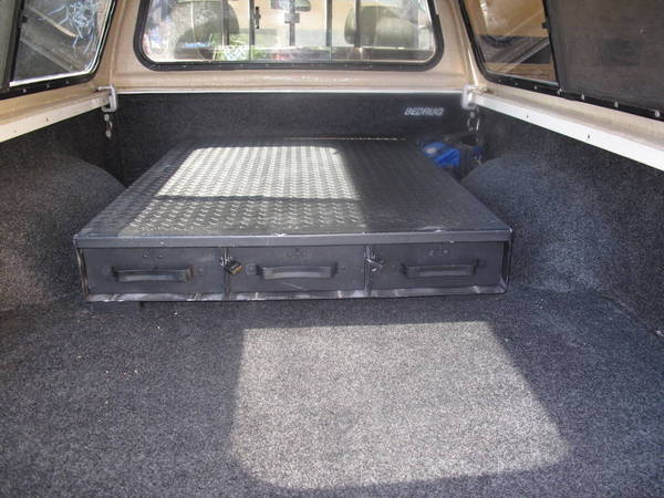

    Found this one on the curb on heavy trash day. Cleaned it up and it has worked good for me.

    Cool! I can think of a bunch of uses for that thing. Never seen one like that.

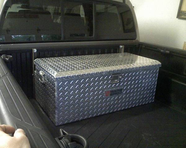

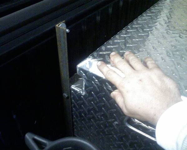

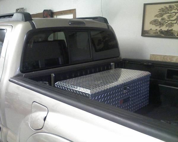

    Finally arrived. Don't know what the holdup was but it's here now. Just need to thru-bolt it someday. I'm not a fan of the J-hooks.

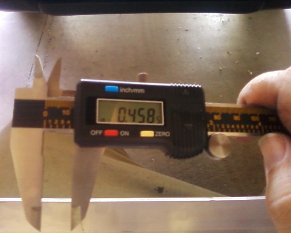

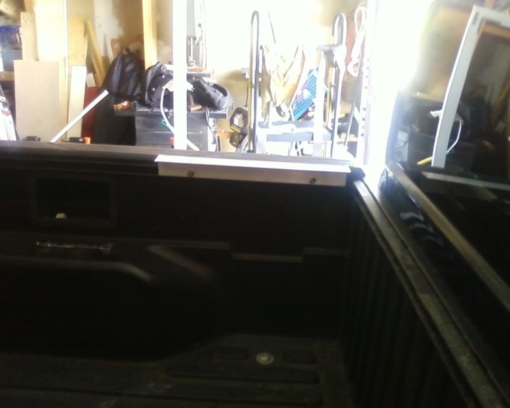

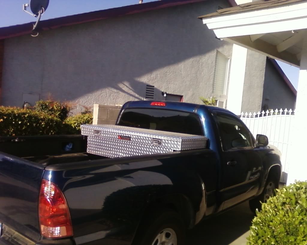

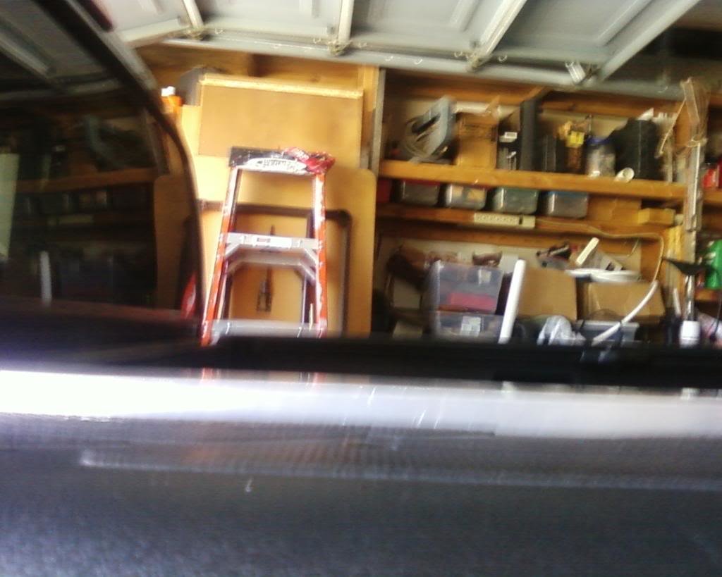

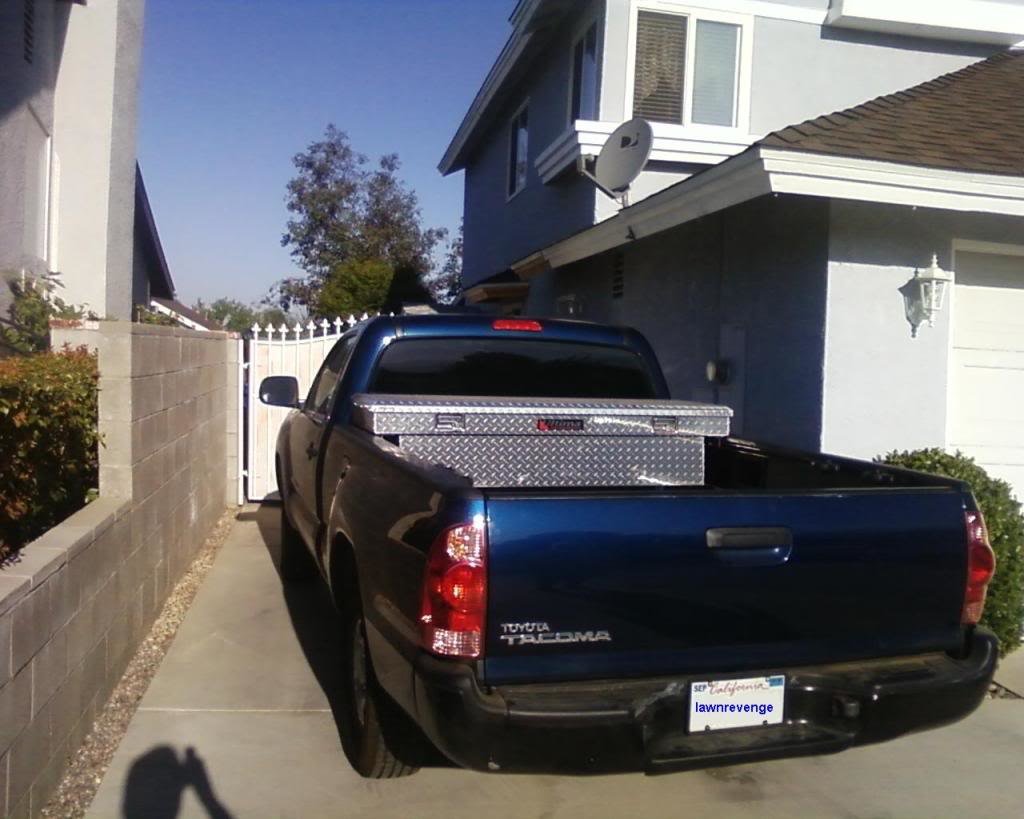

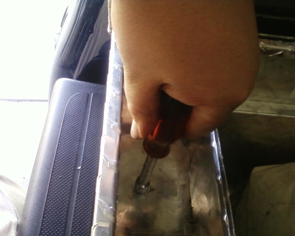

    I just remounted my toolbox to the rail. Was using j-bolts that constantly came loose from stretching etc. Also, the toolbox only rested on the bed about 1/2" on each side.
    So I got some 2" 1/8" aluminum angle iron today (is it still angle iron if it's aluminum?)
    Mounted those with 3/8" bolts and washers to the bed rails and mounted the box to those. Now the box is supported by 2" on each side. It seems to be sturdier.
    The holes are centered
    from the bottom edge and rest perfectly on the rails. The toolbox now sits 1/32" above the bed on each side. The photo sucks but I took them with my phone, didn't feel like looking for my camera.
    the trick is to drill the holes in the box so that the nuts jam against the angle iron and they are easy to bolt down. A little locktite and it's on very well. You'd have to look to see how it's mounted, no one will casually see that it's any different from any other tool box.
    I'm planning a different setup later this year that has a bike mount, jerrycan strap and some tiedowns on a beam behind the toolbox.

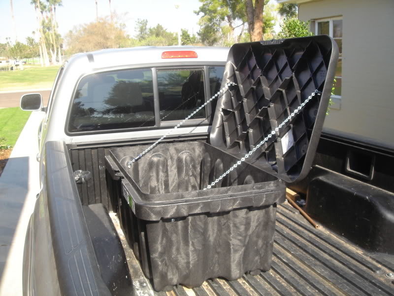

    Got them at the local army-navy store (actually in Pomona CA)
    M & I Surplus
    2090 N Garey Ave
    Pomona, CA 91767
    They were about $10-14 each. I don't recommend them unless you don't mind you stuff getting wet. I've since replaced them with a real tool box. that I just posted about mounting correctly. I did really like the look of them, just outgrew them.

    Thats awesome :D and free!
