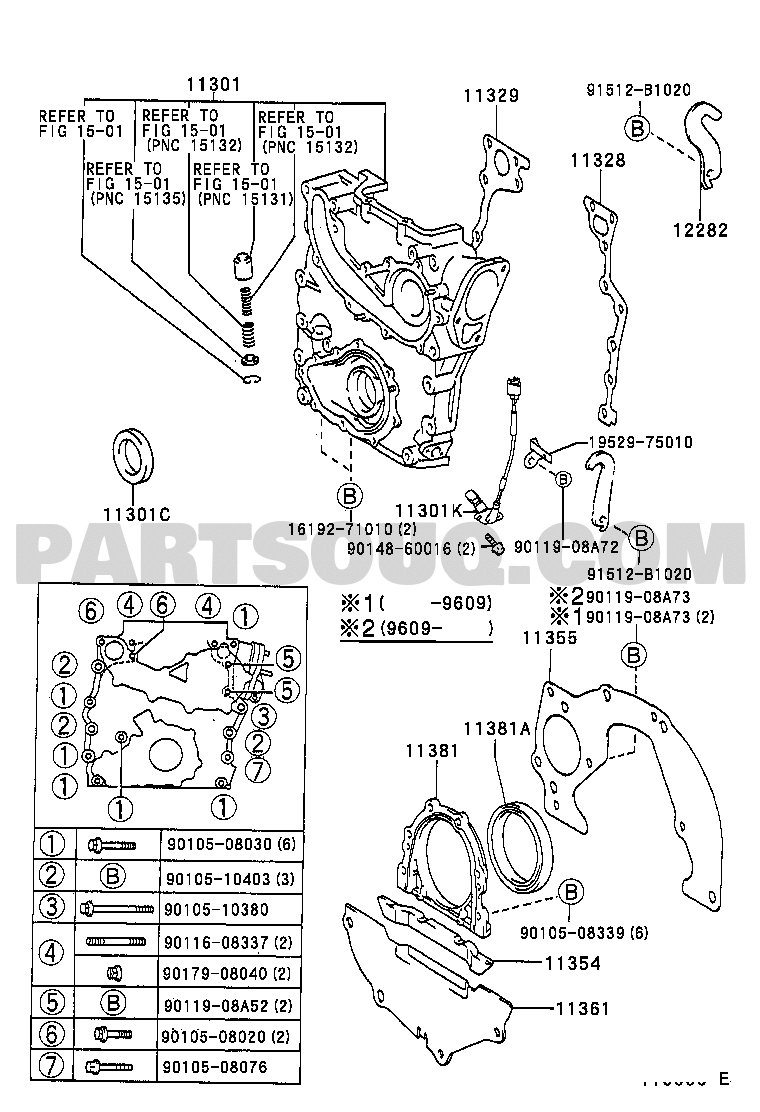

    When I was reinstalling the crank sensor I thought I felt a "crack" but nothing looked broken (hard to tell behind the alt bracket) and it's not leaking oil.. if I did break the case would that effect the sensor? Is there an ohm reading I can do to verify if it's still good?

    So I'm not getting spark, will the 3rz still send spark if it's not getting a signal from the crank position sensor? Also is it possible to test the CPS while it's still installed on the truck or do I have to remove it and bench test it (like I read in the 5vz repair manual)
    Given its location I probably have to drain the engine of oil correct?

    Where about on the block in the diagram is the crank position sensor at? Might not have to drain the oil. The oil level is prolly below that sensors opening into the block. Could always get to the sensor and start removing and if need drain oil, just snug up sensor and drain a quart or two and then go back to sensor removal. If that sensor is failed or damaged or for whatever reason the ECM doesn't see the pulse signal from the CPS then ECM will not power the fuel pump circuit.

    In relation to that diagram you posted the sensor is located in the timing cover where it bolts into the block by screw 11416 in the lower left of the top half of that picture

    Okay I found it. Kind of in middle of image but pertains to upper image.
    I do not believe the CPS resides below the resting engine oil level, so should be fine to remove while oil still in the engine.
