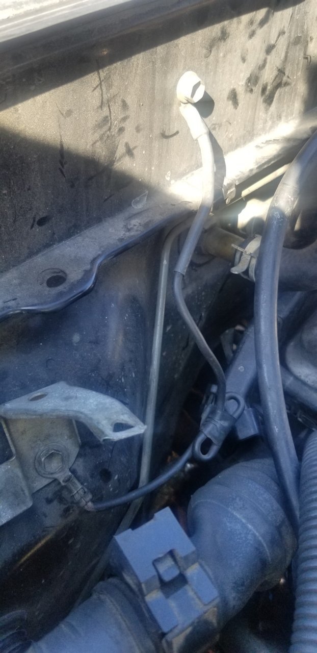

    98 4x4 ex cab tacoma 3rz
    Is the ground you're talking about that should go to the head? I thought it was wierd that it went back to the ecm connector

  8. Aug 14, 2019 at 4:20 PM
    #48
    se7enine
    se7enine MCMLXXIX
    Apr 18, 2013
    #102322
    23,442
    Reno, NV
    That goes to the head
    Fixed it's placement and still just cranks
