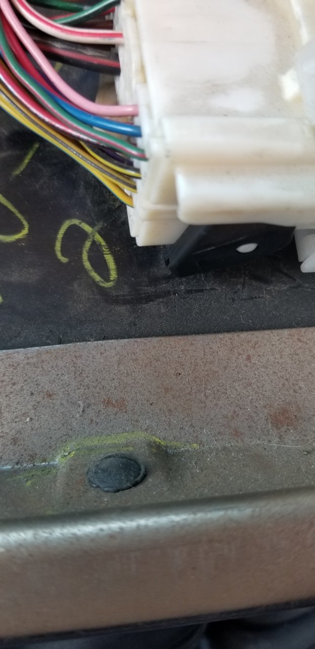

    10 days later I finally got around to finishing this leg of the journey. Thank you so much for all your help, in the end it was my own stupidity that was the major hang up, a plug from the harness that goes behind the glove box had a black plastic cam lock and I pushed the plug in but neglected to flip the lock so it wasn't fully engaged... plugged it in and boom! Fired right up
