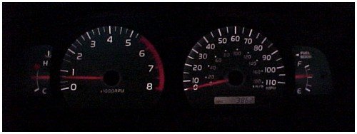

    I got a pic for ya... :D

    Mine...
