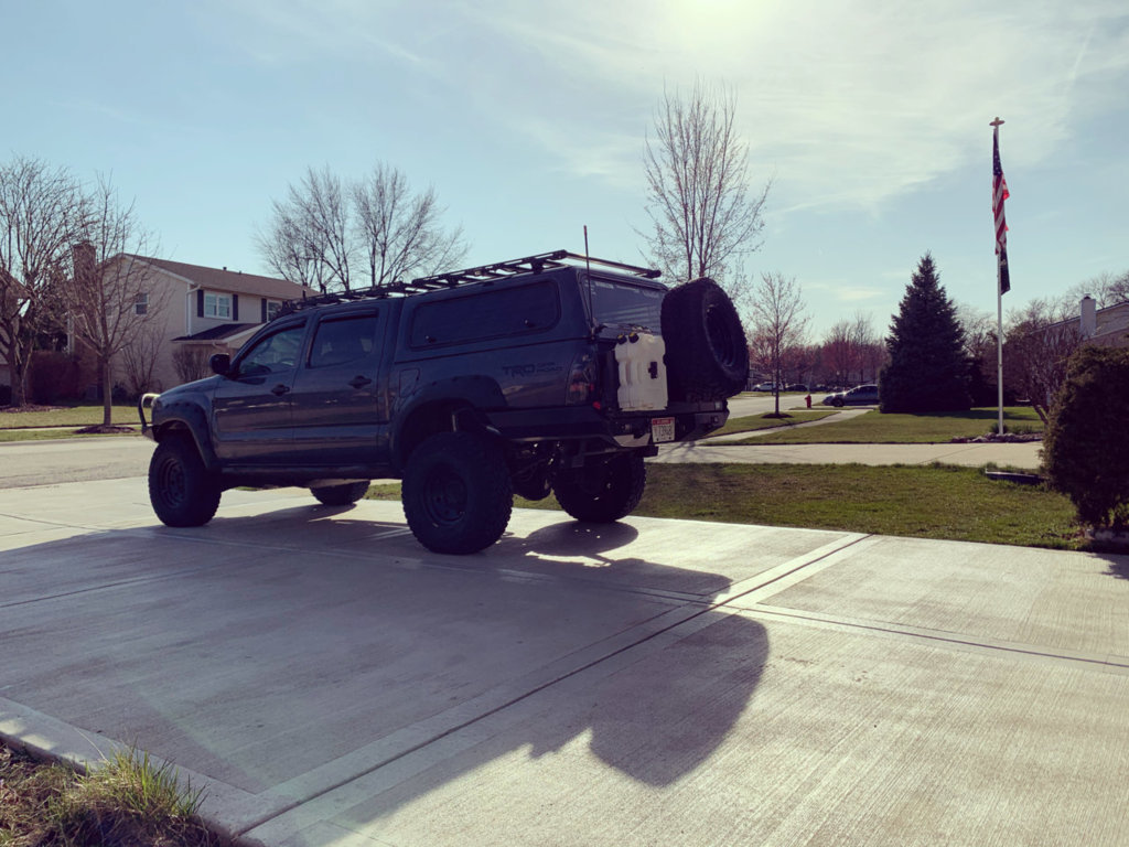

    I have them. With a constant load of 500 lbs off the back, the Dakars couldn't hold up. Much happier with the Deavers:

    I have the darkars now lol. I have the heavy duty pack but after about eight months they’re starting to sag especially with the load. is that pic of the stage three ones? How much a Lyft did they give you off the back non-loaded? I hope they give me a 3 inch lift

    I believe it is 3".
    I have a heavy bitch though. Not sure what it would be with an unloaded, first gen access cab unloaded. I have a constant weight in the rear.

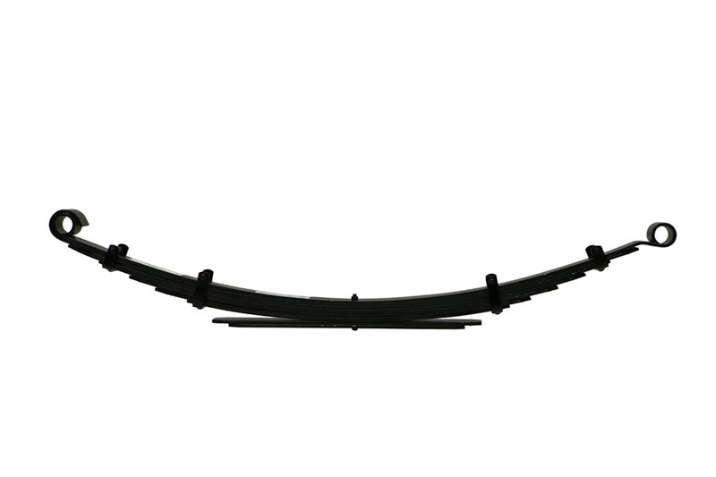

    I had stage I's and II's... both had 9 leafs. Just depends on the material thickness... Deaver sometimes add more or less leafs to achieve the desired loading.
    Edit: here are the stage II's with 9 leafs.
