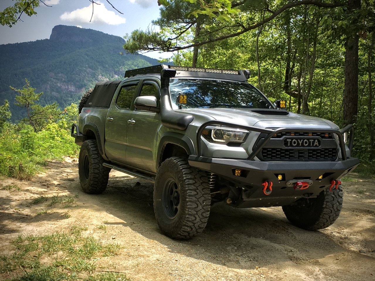

    7D9631D1-9795-4463-8EF6-E7AAD55B628C.jpg I have them, also have the Archive garage hangers installed...ride quality for me has not changed. At least what I can remember.

    I don’t know if you looked at my build, but I’m running 35”. Plenty of clearance, wheels extremely well even as a long bed...

    I didn’t realize you had 35s. Even with 35s, that’s a huge lift in the back. I’m only 33s. So I can imagine if I got stage III, it would be really tall me back lol
