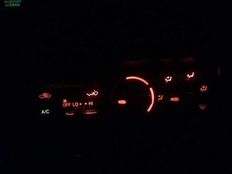

    I've always considered using incandescents with condoms (red) for my lighting needs. I did use LED behind the climate control face plate and am happy with it. But maybe I'll try the former for the gauge cluster.
    FYI re: the 98-00 climate face plate. The portions that light up are clear/translucent with the exception of the temperature range colors (blue-cold, white-warm, red-hot). Those are painted on. FWIW with the red LEDs behind the face plate my temperature controls are now all red with the exception of cold, which doesn't let any light through whatsoever, so it's blacked out.
    I found that to be a bit strange that a green light will illuminate that portion of the range blue, but a red light won't pass through at all. I'm sure my high school physics teacher is disappointed that I don't remember spectroscopy and light filters well.
    Either that or the beam angle is too narrow for the LED bulb and it isn't lighting it up at all versus the incandescent.

    I found the key for the HVAC lights is to be sure you get ones with side LEDs as well as one pointing straight out, otherwise the buttons don't get lit much at all because they only get lit from the light coming out of the side of the bulb.
    but I need to point out that I did replace the faceplate to one without the orange paint so if you aren't changing the faceplate don't bother since anything you do to it will still have some orange tint to it.
    as to the cover plate, the illuminated parts are white and not clear but on the 01-04 models they added an orange paint behind the white paint to give it an orange color that can only be seen when lit from behind. the bulbs in the control will be clear.
    if it is 01-04 original oem then it should look like this:
    if it is 96-00 original oem then it should look like this:
