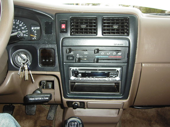

    an easy way to tell what your HVAC faceplate really looks like is to pull the knobs off (be careful not to lose the metal clip that always pulls out of the vent selector knob and push it back into the knob) once the knobs are off gently pry outward on the faceplate by sticking your key or screwdriver behind the holes for the knobs but be gentle and wiggle as you do so nothing breaks. then you will see that orange paint behind it

    '00 tacoma 2.7 4x4 reg cab 5speed x's 2. '01 T4R 3.4 5 speed
    This^^ is the 98-00 style. 99.5-97 is all sliding controls, with the pull out cup holders just above the controls.

    ahh, ok, thanks, its always good to have the most accurate info posted
