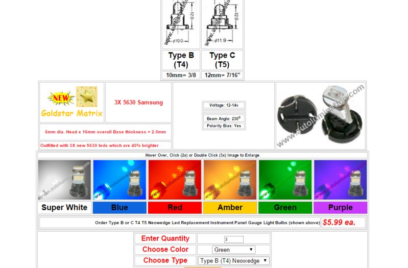

    no, that's a #74 not a neo wedge, you need the neo wedge t4 bulb.
    scroll down about the middle of the long page and find the goldstar matrix 3X 5630 Samsung for $5.99 each, you need 3 of them

    Didn't see your edit. Found them though. I will order these once I get everything settled out.

    get those and you will be happy :thumbsup: you need 3 of them

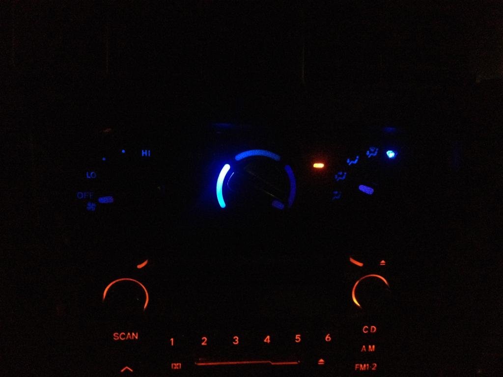

    I'd have to disagree. I am running the neox 4mm's and my AC lights look great with the proper panel.
    The 4runner faceplate mate all the difference since this is what it looked like before:

    well where are your button lights??????????????? not visible, and that is because you don't have the side facing LEDs on your bulbs to illuminate them. THATS why you need them. bet you probably never even noticed or cared they weren't lit but they should be

    Wait what button lights? The buttons light up stock orange when on. Got a pic to show me what you mean?

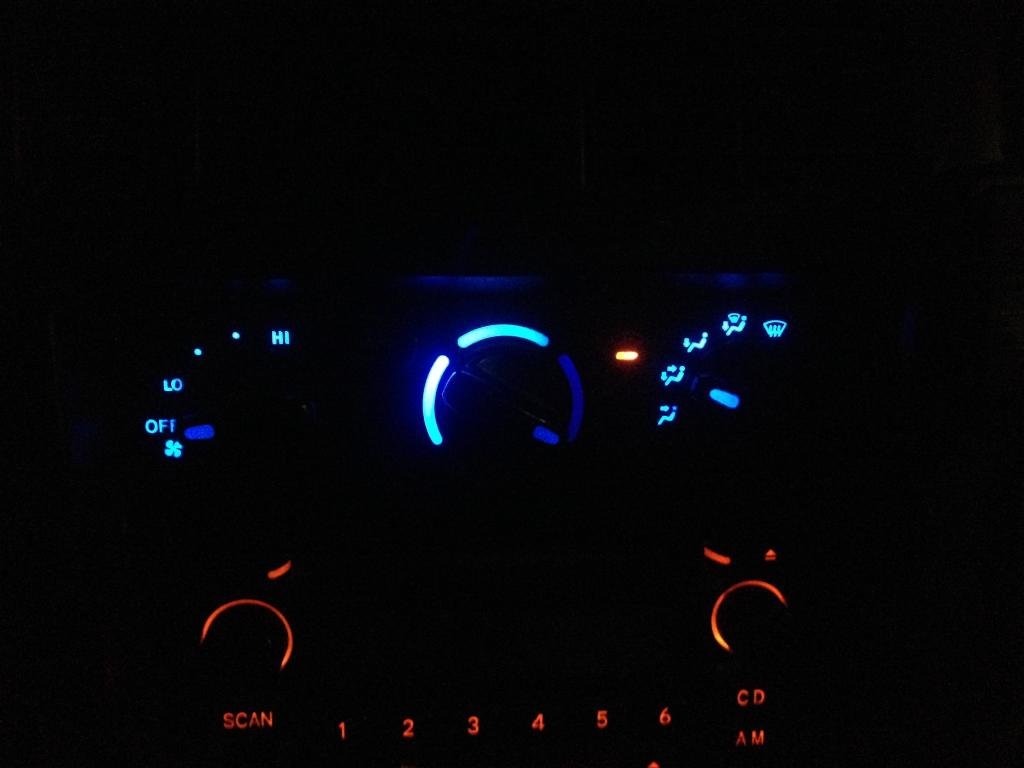

    the a/c and rec symbols on the buttons will light up if you have the correct type of bulb, see here:

    Ahhh. Hmm Me thinks I need new bulbs. :thumbsup:

    That looks good, can't wait to see what mine will look like green :thumbsup: btw I just ordered the faceplate. Seller wanted $40 so I accepted and I took $10 off since I used paypal :jellydance: winning right now.

    those are the super bright whites, if you go green I think the blue part may not light up much at all but the rest will. for some reason only white seams to light up the blue part.
    great news you got a better deal, just remember if you just use that other control it has green LEDs for the buttons so it will match your green color scheme perfectly. its the exact same control, so no worries about it not being the right part to work in your truck. the part numbers are only different because it has green LED buttons instead or orange so all you have to do ids plug it into your dash.
    I personally HATE the orange LEDs on our buttons so even if I wasn't doing a light mod, I would have changed the control just to get the more "normal" looking green LED buttons
