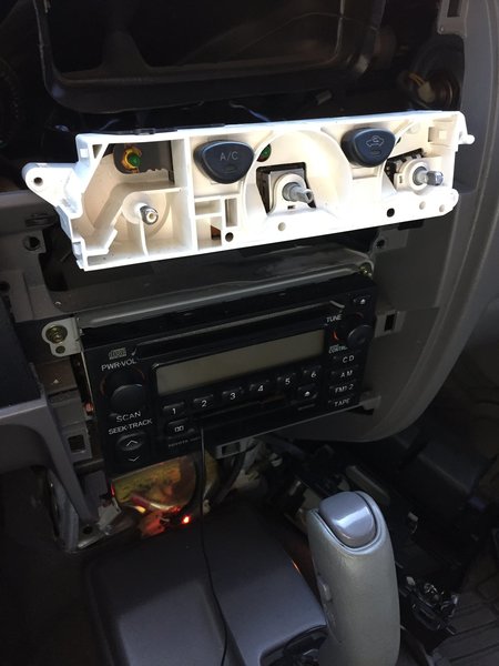

    tacomatrd22
    tacomatrd22 TRD SuperCharged Tacoma
    Sep 20, 2014
    #138725
    1,559
    Daniel
    Fort Smith, AR
    Supercharged tacoma
    FlowMaster Super 44 2" lift Gray wire Fog light
    Well I was excited to see my 4Runner A/C controls work but the damn lights won't turn on.
    As you can see the bottom bulb and radio is lit up but not the control.
  18. Oct 29, 2015 at 10:13 AM
    #358
    keakar
    keakar Well-Known Member
    Oct 2, 2014
    #139537
    5,258
    karl
    louisiana
    2006 4runner sport 4.7L V8 (white)
    used to have - 99 2.4L I4 5 lug & 04 prerunner v6
    do the switch LEDs come on? check the plugs are all the way on.
    I suppose one or two of the bulbs could be burnt out but I wouldnt think all 3 would be, cover it with a towel so its dark in case they are just very dim and hard to see.
    also if the dimmer switch is unplugged then the lights for the dash cluster and heater control wont work

    I'm sure the bulbs are dead. So I put the green condoms on my stock A/C control bulbs and 2 of them work. After spending over 30 mins messing with the bulbs, 2 out of the 3 work. I was tired of messing with it so I just assembled it back together. I checked after everything was put together and all 3 work. Checked again one wasn't working again but after a few seconds it finally came on.
    Edit: does anyone know what size the cigarette bulb takes? Going to change that out as well.
