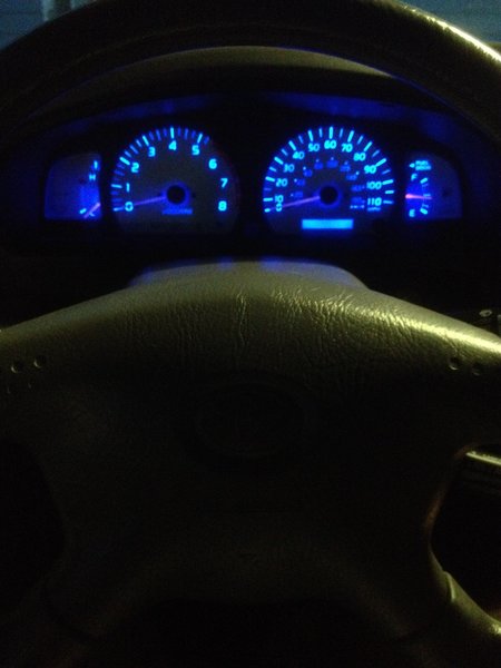

    did you have orange paint behind your HVAC face plate? If so how did you deal with it?
  5. Nov 2, 2015 at 5:19 PM
    #405
    Sicyota04
    Sicyota04 Slowly but surely.
    Jan 9, 2015
    #145940
    3,552
    Morgan
    California
    04 DC 4x4
    I did the gauge cluster blue and I ordered the Neo wedge 4mm HVAC bulbs in blue but isn't there orange paint behind it so you either have to scratch all the orange off since I'm using blue or order a 01-02 4Runner faceplate? Which is what I did today since it doesn't have the orange stuff. What did you do to correct that orange crap behind the HVAC plate?

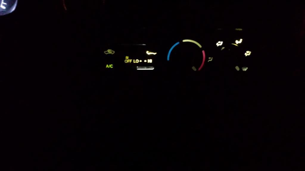

    I bought a 4Runner HVAC out of a 2001 SR5 from eBay :D
    The Limiteds have the digital dual-zone climate or w/e that thing is so it doesn't work (or at least I wasn't willing to risk it)

    Sweet! I bought a 4Runner HVAC out of an 02 SR5 today from my local parts yard that will be here tomorrow. So you just replace the bulbs & faceplates?

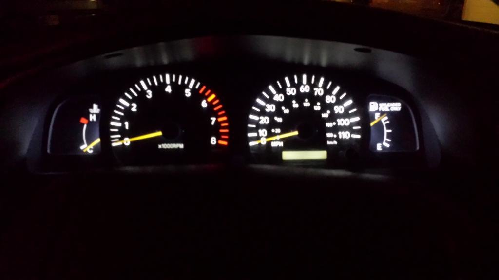

    the climate controls are painted orange behind the plate, bulbs are regular incandescent. the cluster bulbs have the orange condoms on them. same with auto shifter
    the difference with the 4Runner HVAC is also the A/C and Recirc buttons are green instead of orange.

    So I'm putting blue NEOwedge 4mm bulbs behind the 4Runner HVAC. That shouldn't look too bad with the green A/C & recirc buttons compared to my 04 Tacoma orange right? I'm putting the 4Runner faceplate regardless

    But since I'm only installing the HVAC faceplate won't I still have my same AC and recirc buttons from my 04 Tacoma? I'm not changing out the whole thing

    Yeah so since I didn't buy the whole unit just the faceplate it will fit backover the AC and recirc buttons when I put it back onto my original HVAC unit. Right?
