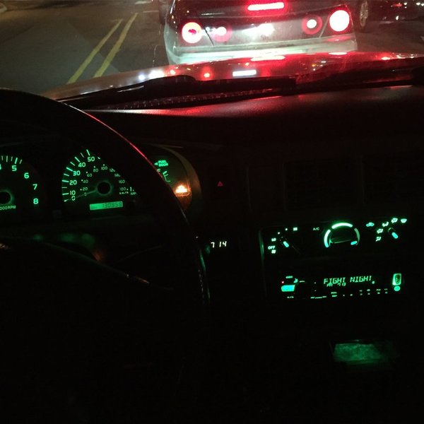

    can you post a pic of the finished setup? Also, did you use the 3x samsung LEDs from autolumination?

    There you go

    Thanks. Looks awesome. Did you use the same LEDs I linked a couple of posts ago?

    That looks sick! Purple?

    Yes the Samsung 3x something. I'm sure you read it right, multiple pages back on this forum.

    It's blue

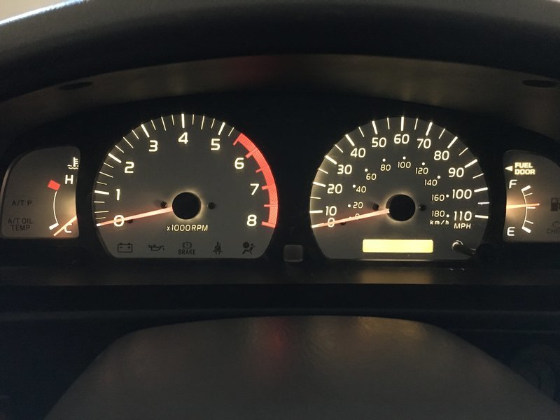

    maybe just because im old, but after trying several blue versions and settling on incandescents as the best "natural" look, I decided to go to whites in the gauge cluster to match the climate controls.
    it has a nice white gauge look in daytime and at night the gauges look dark gray with white numbers and its very easy to see in all conditions, even the transition times at dusk and dawn.
    just thought I would mention white is a very nice look so you don't "have to have" a color bulb

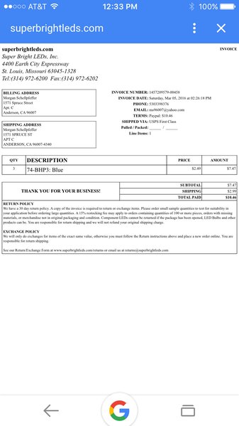

    I bought the #74 bulbs but someone was saying the bulb that goes into the automatic gear shifter doesn't want to stay in. It keeps falling out. How do you get it to stay in and not fall out? I bought 3 blue LED's one for the glove box, one for the shifter & one for the ashtray.

    I used a small little knife and moved the little metal connector closer towards the middle. Has served its purpose.

    I put the glove box, & shifter blue LED lights in and had no problem with the shifter LED light staying in. Haven't tackled the ashtray light yet. Also even though the LED light is blue on the shifter the R stays Orange.
