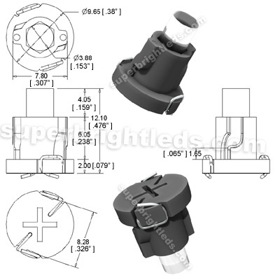

    The shifter & glove box are #74 but the HVAC leds at least on my 04 were neo4's

    No prob man. Those neo t3 lights work for any of the similar buttons as well...ect, diff lock, clutch start cancel, hazards etc.

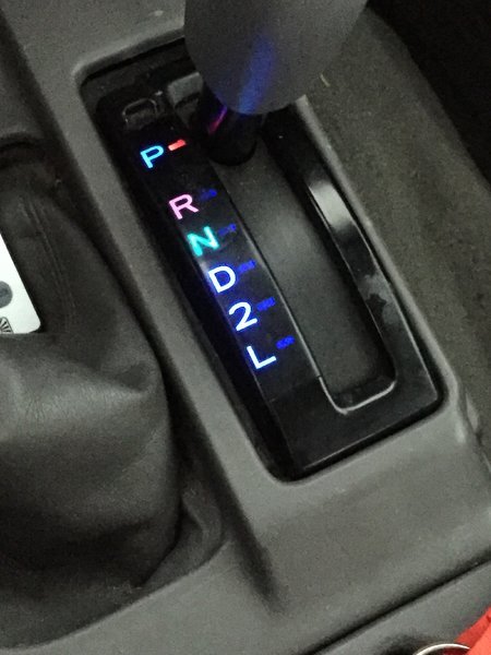

    For the shifter? My #74 fit perfect for the shifter. Here is how it looks. Keep in mind this is a daytime picture. I chose blue all around on all my leds.
  11. Jul 7, 2016 at 8:35 AM
    #591
    Sicyota04
    Sicyota04 Slowly but surely.
    Jan 9, 2015
    #145940
    3,564
    Morgan
    California
    04 DC 4x4
    It doesn't really make the letters blue overall. Just the dashes next to the letters. But I'm not gonna change it

    I used NEO4 on the AC. I had to trim the tabs a bit for the Hazard Switch and Diff Lock switch so maybe NEO3 is better. Main thing is to get the ones that have the lens on the top so you get a 360 pattern.

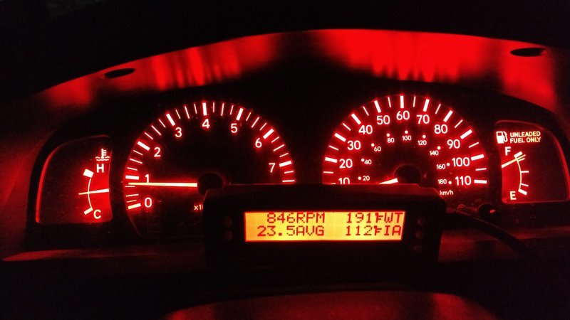

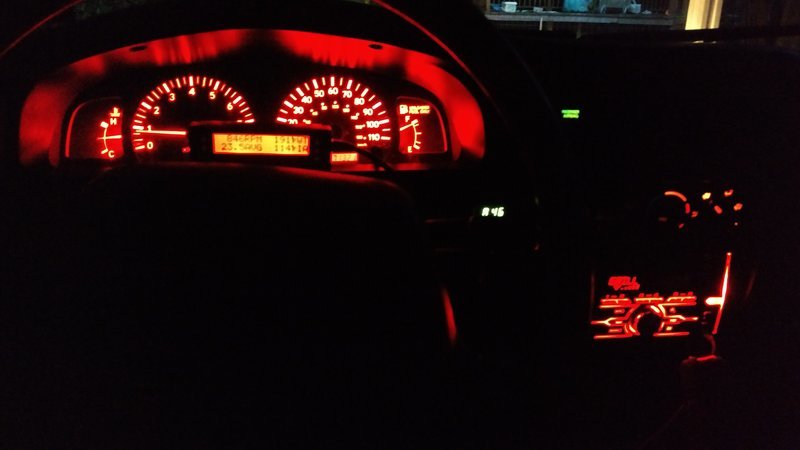

    Im gonna go with red a NEO3 on the AC and see how it turns out and red #74 on the shifter and HVAC panel

    They will fit perfect. That's the factory size replacement.

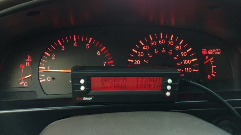

    Looks like he has a tach. Looks good @Brice

    That's not a Tach. Its an infinitely-variable clock.
    Lol but seriously, Get the wide angle lense'd 194's and you should be fine. I used 4.

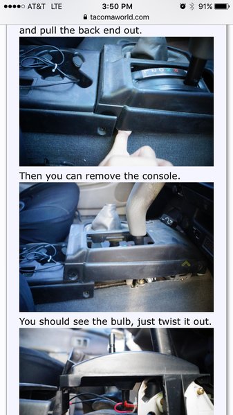

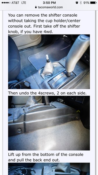

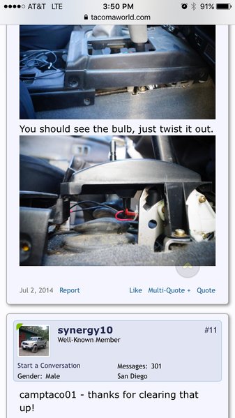

    I still cannot get to the damn ashtray bulb. I took the whole bottom part off. Is it the actual ashtray or where the cigarette lighter is orange on the inside? Where is the bulb located? Does anyone have a picture of it disassembled? With bulb showing? It would be much appreciated. Thanks in advance!
  20. Jul 20, 2016 at 2:27 AM
    #600
    alphabravo
    alphabravo Well-Known Member
    Jan 6, 2014
    #120082
    1,735
    Christopher
    Canada via FL
    2003 Tacoma TRD
    Supercharger AntiDark Hood Light Redline Tuning Hood Struts Morimoto Projectors Grey Wire Mod Tundra 13WL Brake Conversion EBC ED Pads and GD Rotors Mean Green Starter DC Power 250A Alternator Odyssey PC2150 Battery, Artec Cage ADS shocks Total Chaos UCA ComeUp Winch, Factor 55 Splicer Relentless bumpers OTRATTW Switches, Bussman 15304-2-2-4 RTMR, Paranoid Fabrication switch brackets Jensen JHD3630BT Morimoto XB LED Fogs Deaver Custom Springs Ivan Stewart TRD Wheels, Pro Series TRD Wheels
    There are two screws that hold the metal ash tray slider into the console. Once the screws are out the tray will slide partway out held only by the ash tray wire and bulb holder which is connected to the center/top of the tray. The bulb holder might be a little grippy the first time you remove it but it should pop out.
    The ash tray light wire has a grey plastic insulation cover around it. Sometimes if the bulb holder pops out of the ash tray frame then the wire will pull back into the space under the stereo making it hard to find. Yours might have just popped off.
