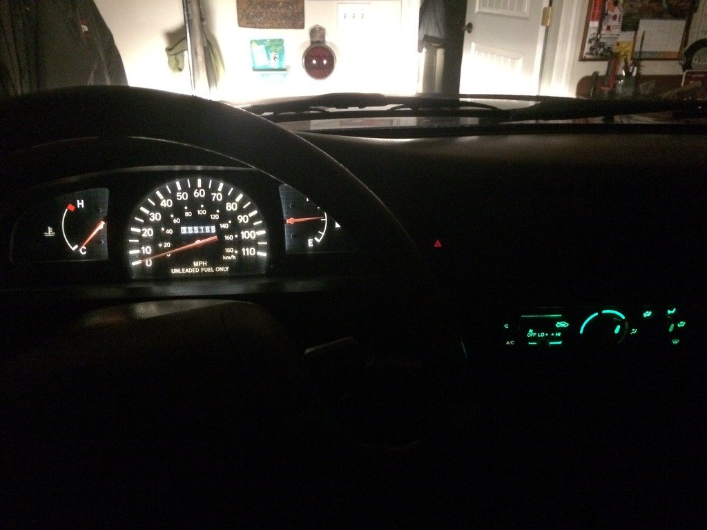

    4. 194 for cluster 2 for heater a/c controls just did mine sunday

    how do you like the white led at night? And what color temp is that? cool white? Natural white?

    I have white in mine. Its great at night. I have dimmed as much as possible and I love it.

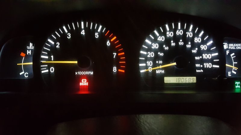

    Just finished up doing my 1999 with SuperbrightLEDs and went with the "Natural White 4100K"
    https://www.superbrightleds.com/mor...-tower-miniature-wedge-retrofit-car/206/6773/ for my cluster and it's way too bright.
    They also aren't dimmable and they're way too bright when driving at night. My green HVAC LEDs I installed also arent dimming but my stock headunit still does, so I'm not sure what the issue is. Wondered if anyone else ran into this issue with their early first gens as it seems everyone with a later first gen has no problem dimming their LEDs :(:(
    Was thinking I could maybe go with a different color like the "Warm 3000K" or Amber, or Green for cluster and they wouldnt be as bright ???
