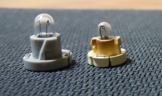

    If I remember correctly they are quite expensive - I think I got it at Toyota parts (before I went to LED).

    I lied :smack:. My memory does not serve me as good as I thought. A/C switch has NEO3 bulb in it. I just found an old A/C switch and was surprised to see that bulb in it. I guess I replaced it with LED too (I know I replaced all bulbs except cluster warning lights) - that was 5 years ago and seems like eternity.
    On the other hand I'm quite sure (if my memory serves me good on this one) the hazard switch also has NEO3.

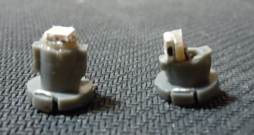

    As instrument cluster I think these T10 will suck as they project light in one direction only so there will be not uniform backlighting. If you like blue, for instrument cluster much better would be with https://www.amazon.com/Alla-Lighting-Replacing-Interior-Courtesy/dp/B01KXY8Z8Q/
    These T4.2 are not SMD, it looks like normal traditional LED. These are SMD: https://www.amazon.com/dp/B072TR6N5S. I don't know new version air panel so I can't tell how they would work in there.

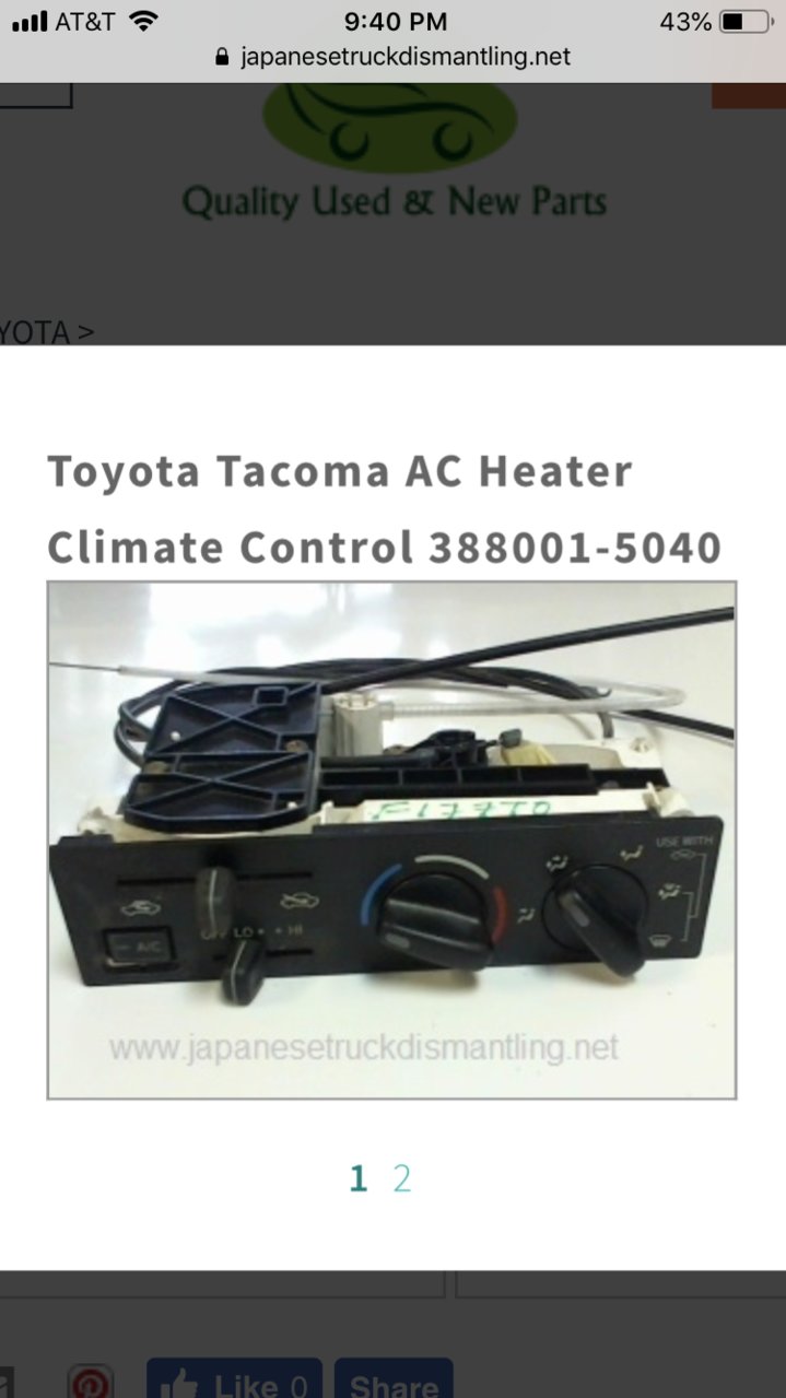

    Hi I’m new to the Tacoma forum, just bought a 2000 Tacoma, the climate control light is not working. I am wanting some LED but I’m not sure which size to get. I would like to do the dashboard as well while I’m at it. I would truly appreciate some info on this. I love my .

    The climate control lights are a little tricky if you want LEDs . If you are not changing the color I would recommend buying the stock part .
    I am trying to change all of my lights colors to blue. I have bought two different types of LED for the climate control and while they appear to be the same style of light and fit, the measurements are a little off and they do not fit properly .
    I will post pictures of my project once I have all the parts necessary . My project is a little different because I have a 2002 which has an amber backing to the climate control light cover . I will be taking the climate control light cover off of a 2001 forerunner at a junkyard to get the right color background (White)

    Sounds good, I’ll keep it simple going to auto parts and get a bulb. Appreciate the info fellas. :thumbsup:

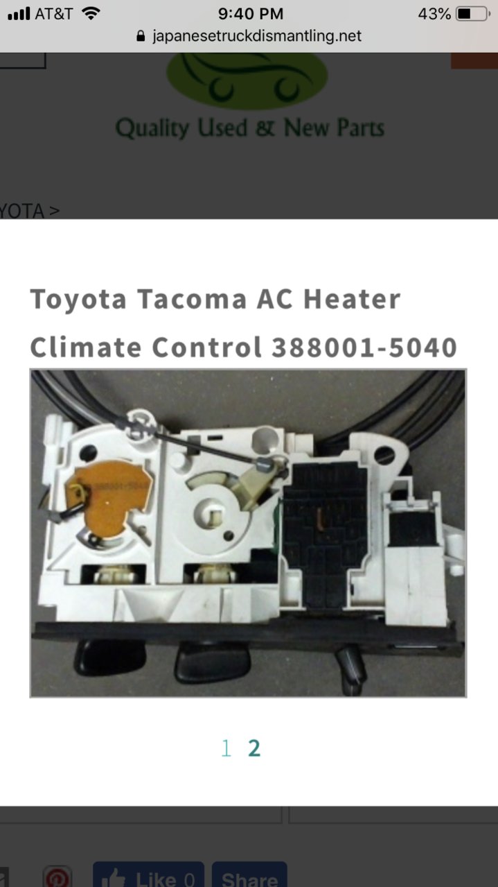

    I tried replacing my lights for the climate cluster but the piece is not the same as the one in the video. Mine is a 2000 and I notice there is something attached to back besides the two clips. I couldn’t remove it, it’s not as easy as it what shown in the video. Has anyone changed there on a 2000. The layout is a little different.

    Here’s how mine looks

    I got it!!! Lol :bananadance:

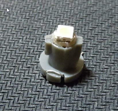

    Hi. What led is that? I am having trouble finding. I tried
    cciyu 6 Pack T4/T4.2 Neo Wedge 2835 SMD LED Bulb A/C Climate Control Lights (red) and they didn’t fit.

    Are you having trouble getting them to lock into place?
    I had to clamp down on the leads on the bulb with a needle nose pliers to get them to lock into place.
    You may have to trim a paper thin piece of plastic off of the locking mechanism as well .
