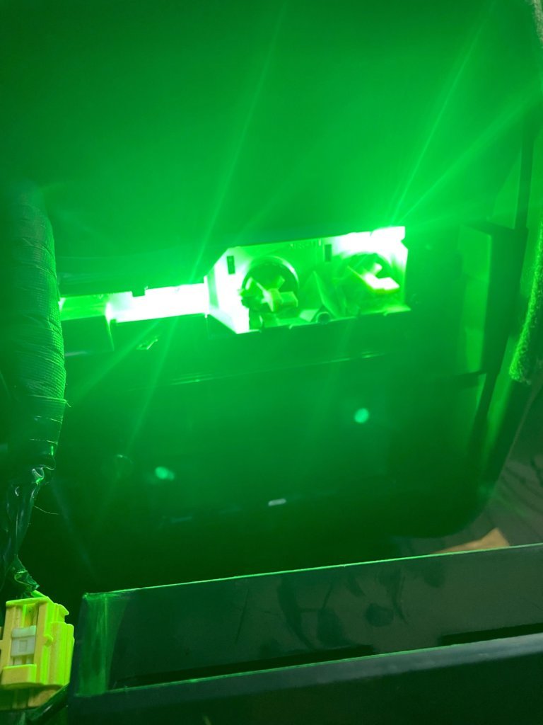

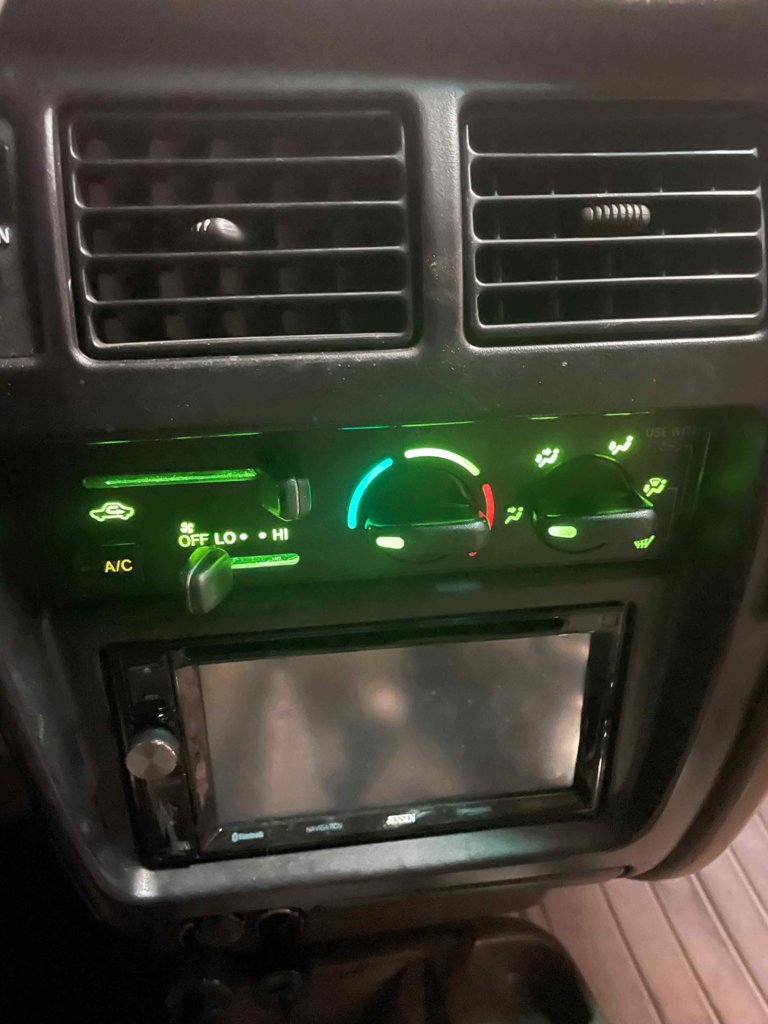

    Climate control LED with front panel on.jpg Climate control with new LED installed.jpg
    I got tired of not being able to see my climate control panel at night since the new halogen bulbs were not working with the sockets that they were installed into. I went out and bought a set of green LED bulbs from Amazon. The light socket on the left side of the climate control started falling in. I had to take apart the center dash console, remove the top panel of the climate control module, reach inside, and push the light socket into the panel so it will lock in again. I have been without climate control lights in my truck for years. They're up and running again!:yay: For those of you who would like to get some green LED for their dashboard or climate control panels:
    WLJH T5 Led Bulb Canbus Error Free Car Instrument Cluster Dashboard Led Dash Lights Bulb Replacement 74 2721 17 73 74 3030SMD 12V Interior Dome Light (Green,Pack of 6)
