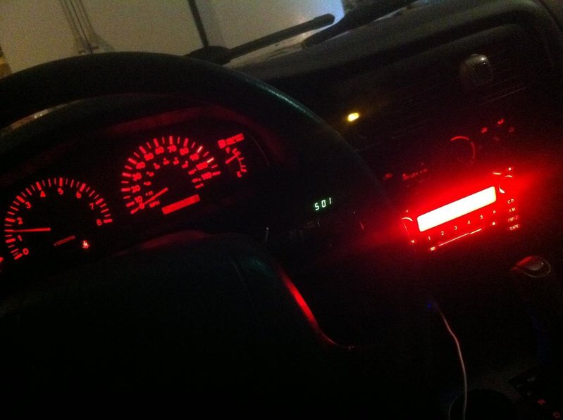

    Aftermarket Sony headunit, White Cluster LEDs, Red Climate Control LEDs
    Just did my cluster white and my climate control red, looks pretty sick.
    It's worth mentioning the red looks a lot better irl

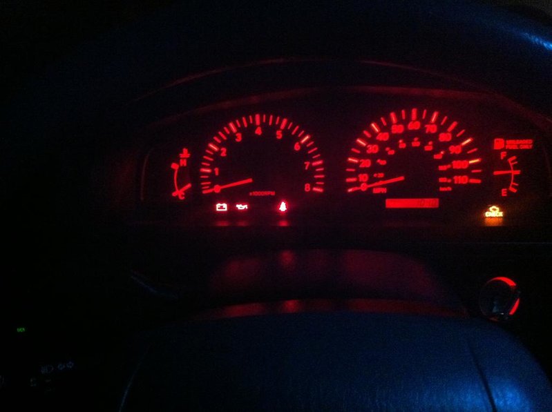

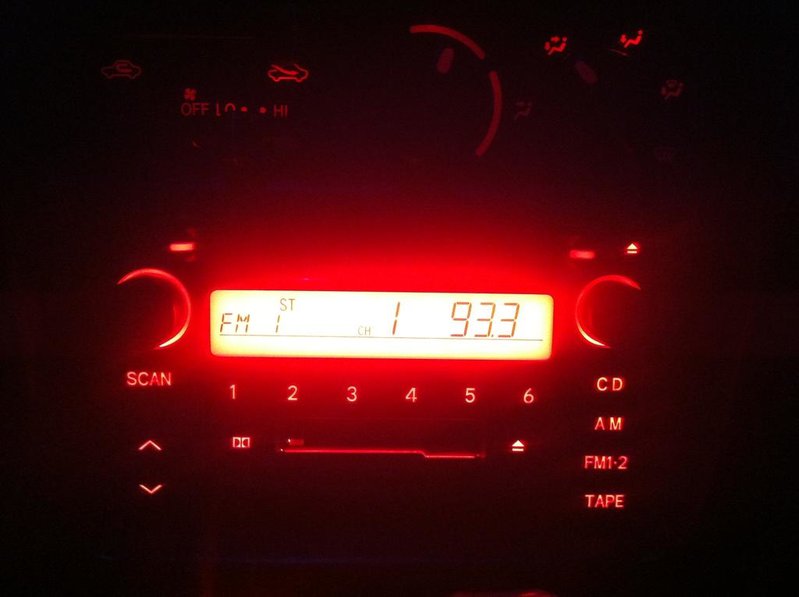

    I did red leds in interior. If you have factory stereo (which i did) then you can go in and individually solder the smd leds in the stereo (which i also did)! :D
    4 194 in cluster
    2 74 in ac panel
    30ish 1206 smd led in stereo
