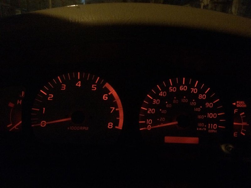

    I had white just like that, looked awesome but I found it hard on the head during long trips. I swapped to red the other day. It looks better in person because I am a terrible photographer and thats the lowest dim setting. haha

    Alright, so I have the 360* bulbs in behind the climate controls. The 25 lumens shouldn't scare anyone... very dim if need be.
    My question (now) is... the blue range of the temperature dial doesn't light up. I'm assuming it's because the paint is less translucent than the white and red. A little bothersome (okay... lots, I'm OCD).
    Any solutions to this? I know I've seen a 4runner "clear" face plate used for the 01-04 guys. Is that a solution for 98-00s? Obviously it's a different face entirely from the 01-04s.
    Don't mind the pic. The light is a nice deep red with very even distribution.
