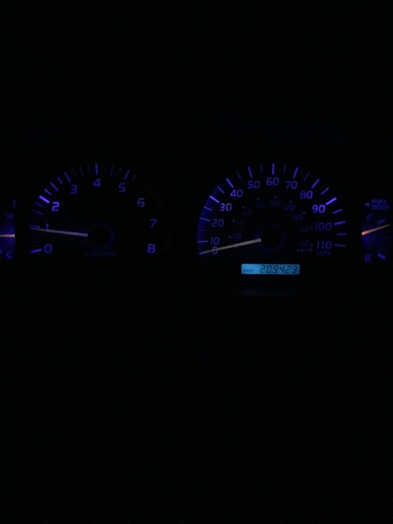

    Just did mine last week. Did the gauge cluster in uv/black light. in the process of doing the ac controls too. Waiting on the 02 4Runner control bezel to come in. Looks a lot better in person 2ef53cb27c0955cba1c51a0caf6cf4fe_14eac57f16df9f4e35a37dd789adc0b9e5d477fe.jpg

    Where did you get the uv/blacklight bulbs?

    Superbrightleds.com
    takes four #194 bulbs

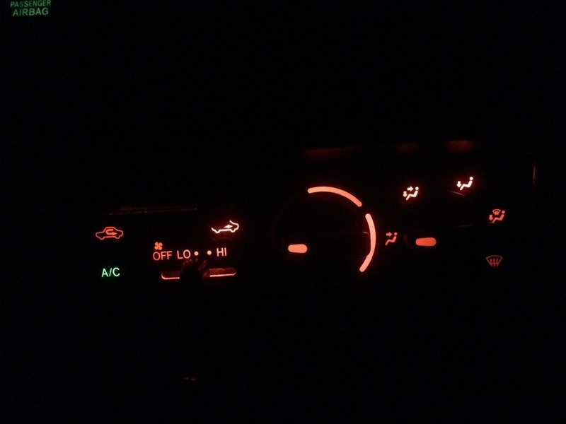

    ok I don't feel like reading the whole thread so can someone sum it up for me?
    I don't want to change every bulb in the dash to blue, I only want to change the color of the gauge backgrounds to blue and the a/c controls to blue but I want to leave all the other idiot/warning lights in their original colors.
    so how many of which bulbs do I need?
    I got the part where I need T10 or 194 bulbs for the dash and i think its the NEO4 for the hvac controls

    There are 4 #194 bulbs for the gauge cluster and 3 bulbs for ac controls.

    ok thanks,
    so I need four of the t10 or 194 bulbs and three of the noe4 bulbs
    i'll get them ordered right away, glad I didn't just buy one of those 10 bulb sets

    This is exactly where I found the bulbs for the ac. It's a pain because it's got to be perfect size
    http://www.autolumination.com/74.htm
    Scroll till you see the bulb that's circled in the picture and select your color704d6505590ecb9f075631363eed9cd2_0884cf94a7d455d766645894515cbba24b1140b3.jpg
