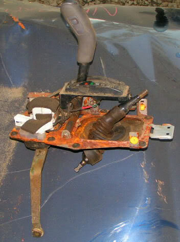

    The notch is to pop your key or something in so if your steering wheel ever gets locked you can still disengage the transmission to move it. But there is a light under the PRDNL letters ;) and the glove box and the ash tray. They take a different type I believe it's a 74 or something but don't quote me I changed all of mine

    Well you know how you can't move he shifter unless the brake is pressed? Which in turn can only be done if the key is in the ignition haha I had my steering wheel lock one time and I could get my key to turn. I'm sure they don't really go hand in hand but it applied to me once :D

    the auto-shifter light is a 74 and there is one. also after tearing apart a shifter not sure it would actually release from park. it's controlled by a module on the base of the shifter plate (little white box) and electronics.

    The white box is the module that interprets whether the brake is pressed or not. To override that and get it out of park use the part noted in previous posts!

    is that the light bulb under the "D" on the shifter with the green wires and red tape? and how do I access it if I need to? how much has to come apart?

    I think it's a process to change those on the 01-04s but I'm sure it can be done haha. For the shifter I only had to pull up the plastic piece around it until I could reach in and turn the socket out

    I believe that's the light bulb.just remove your center console and i think you should be able to access it... Dang it, bella beat me to it!
