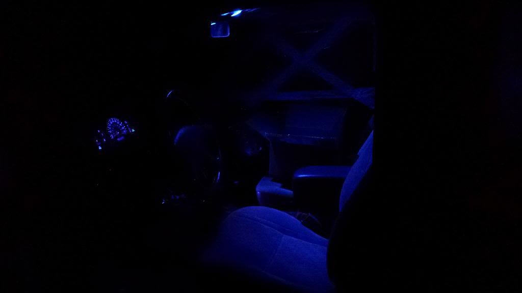

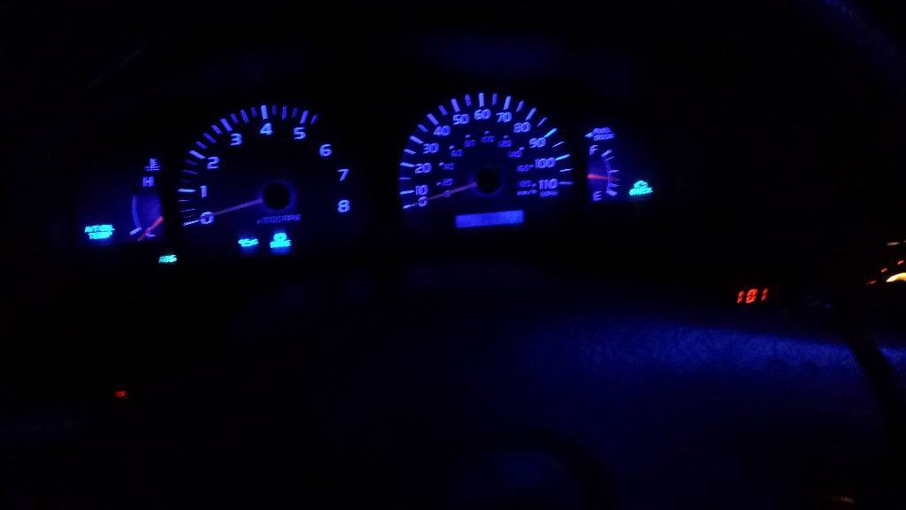

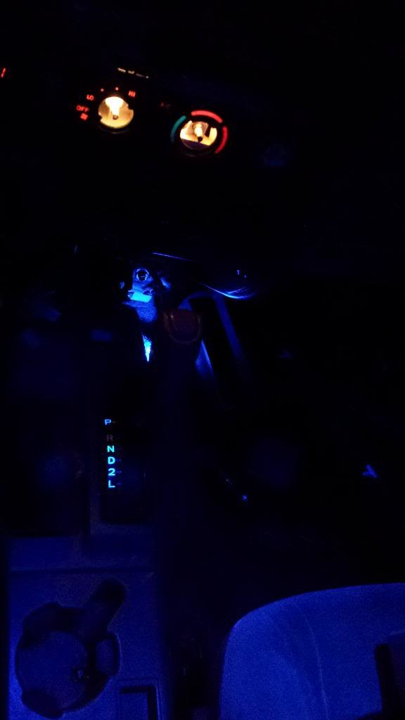

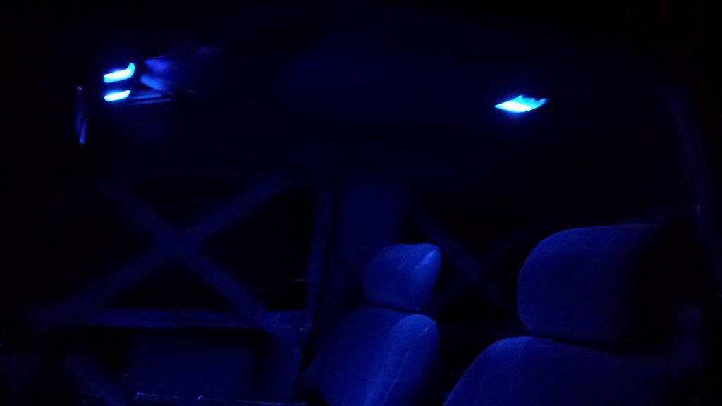

    Swapped all mine out. Got them all from Superbrightleds.com
    Didnt have them done in these photos but I eventually swapped the AC control lights out too.

    also the bulb in the shifter is a 74 and if you want just take off the orange condom and see how it looks. should be a softer glow.
    and yes both the map lights and overhead need a resistor in the 01-04 to operate without ACC or a standard bulb on (it flickers)
