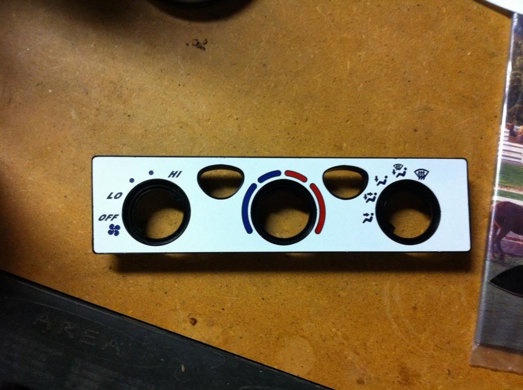

  12. May 23, 2015 at 8:11 PM
    #172
    nelson18matt
    nelson18matt Well-Known Member
    Mar 19, 2009
    #14939
    13,585
    Goodyear, Arizona
    2004 Long Travel Tacoma
    *SOLD*
    like this?
  13. May 25, 2015 at 6:34 PM
    #173
    keakar
    keakar Well-Known Member
    Oct 2, 2014
    #139537
    5,258
    karl
    louisiana
    2006 4runner sport 4.7L V8 (white)
    used to have - 99 2.4L I4 5 lug & 04 prerunner v6
    what the hell is that plate from? must be a 2nd gen or something other then a tacoma? it sure as hell isn't from and 01-04 first gen I ever saw.
    the 01-04 have a white paint under the black top cover paint and on the back side they put orange paint blobs just behind where the design is to show through so with a white light behind it the color shows as an orange glow.
    super bright LEDs can diminish how much orange shows through and its more of a washed out orange "shade" to it however the problem with LEDs is they tend to shoot a beam of light in one spot and not fill the area with light the same way as the oem incandescent light bulbs do
  14. May 25, 2015 at 6:39 PM
    #174
    devinzz1
    devinzz1 Well-Known Member
    Jun 28, 2014
    #132892
    6,979
    devin
    lewisporte Newfoundland
    2023 aclb trd or mt
    icon stage 10 kit, toytec 1" bl, 35" general x3s, 17x9.5 procomp wheels, locker anytime mod, s&b intake, blackhawk 2.1 tune,
    same one in my buddys 4runner.
  15. May 25, 2015 at 6:42 PM

  16. May 25, 2015 at 6:51 PM
    #176
    devinzz1
    Jun 28, 2014
    #132892
    6,979
    devin
    2023 aclb trd or mt
  17. May 25, 2015 at 7:18 PM
    #177
    keakar
    Oct 2, 2014
    #139537
    5,258
    karl
    louisiana
    well where did the white one come from? that's what I was commenting on when you replied
  18. May 26, 2015 at 7:37 AM
    #178
    UssMoGn
    UssMoGn That Vegas dude
    Oct 24, 2013
    #115139
    836
    James
    Las Vegas NV
    05&04 Tacoma SR5
    Home Built Front Bumper HID Headlights LED Cab lights 2013 Radio swap MOLLE DC Insert Traffic Cam F&R 6'' Procomp lift Custom Grillie
    Wow...what the hell is that? haha I never seen a white face plate in any Toyota ever. Still cool tho looks good.
  19. May 26, 2015 at 7:59 PM
    #179
    nelson18matt
    Mar 19, 2009
    #14939
    13,585
    Goodyear, Arizona
    *SOLD*
    It's an aftermarket part
