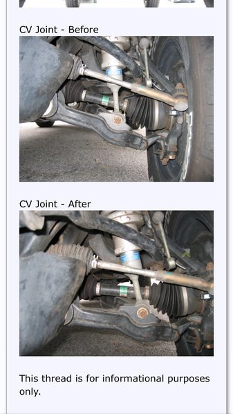

    For the record, there has been ONE failure(~7 years ago)caused by a modified skid plate on a RACE TRUCK during a RACE where he slammed into a rock while RACING.
    The diff drop does in fact improve cv angles on the 2gen Tacoma.

    Thanks for sharing, that's way more change in CV angle than I would have thought... Any extra weight or is it all from the drop kit?
    I can't do it due to AM skid... the ECGS bushing solved my issues anyway. Just to clarify, was that one failure due to RACING?

    I installed a diff drop and cb drop when I installed my lift 5 years ago. I've never had a problem with my cv's after years of pretty heavy wheeling. It doesn't cause any problems and it DOES help with CV angles.

    Correct in the fact that the one documented failure is because of the guy racing. I wish I could find the thread, because I find it hilarious. The guy modified his skid plate in the worst possible way. It had two 3"x3" squares hanging down an inch from the rest of the skid plate. OBVIOUSLY it has potential to catch on something. He caught it on something, and ripped it all to shreds.
    I'm an advocate for diff drops, but I disagree with the pic Justin posted. You can see by the angle of the LCA that both pictures were not taken on level ground. It looks like the first pic has the tire drooped down, causing the CV angle to look worse.
    The diff drop does help, but not THAT much. Enough however that it's worth the ~$30.
