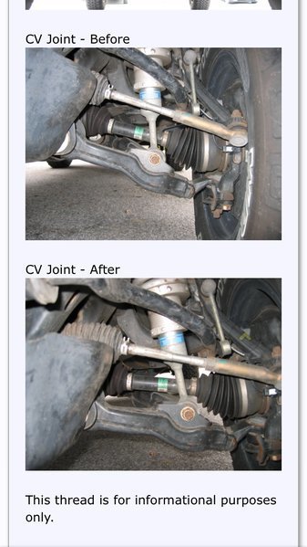

    Judge the fins for yourself. A lot of people just spread information they heard on the internet and have no actual experience with it. :gossip:
    Don't focus on the camera angles, focus on the change in the actual cv boot.

    Both positions on the diff drop mod can be argued well, but at the end of the day it's personal preference. IMHO there's really not an overwhelming amount of evidence to decide one way or another. The angles don't change that much. It would be nice to have a before and after that are taken the exact same way
