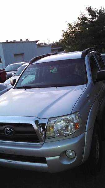

    I am already seeing a few 2GENs on the back lot of my Toyota dealer.
    All have "need frame" on the windshield & their plates are off.
    I walk Simon by this lot almost everyday.
    pic from last night in Burlington, Vt
    maybe someone on here???
    The last go around (1GEN) this lot was overcapacity
    I have a picture somewhere of all the ones heading to the crusher so sad. :(
