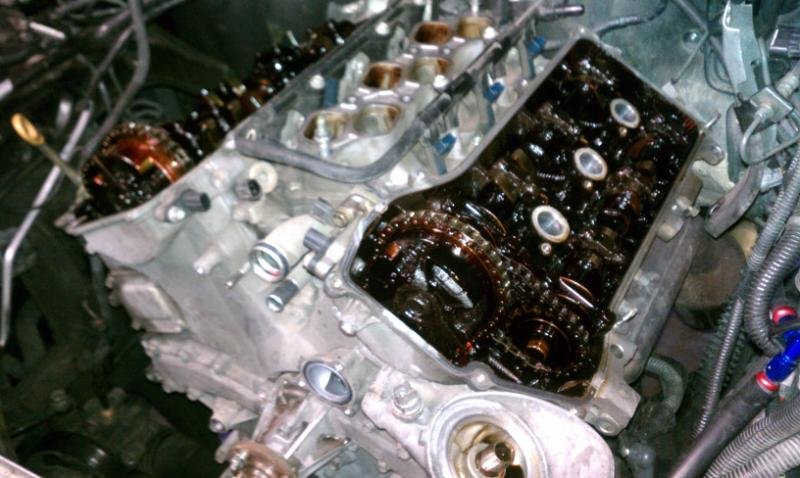

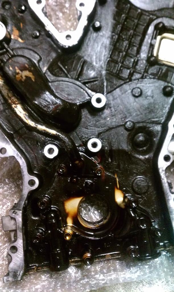

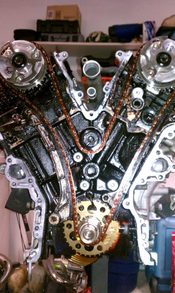

    No. Redline's Engine Break-in oil is an anit-wear additive. Simply put, it prevents wear. It helps to keep oil from moving away from hot spots, so that metal to metal contact doesn't happen. It also helps to microscopically burnish uneven spots, on moving surfaces. To make them more smooth.
    EPA mandated a drop to ~900 ppm ZDDP, in all SAE approved oils for on highway vehicles. That way the ZDDP didn't damage the cats as quickly, as it would at the higher level of 12-1500 ppm (or higher) the problem is, that vital protection is lost. Which worsens, the lighter weight the oil.
    Europeans do it "right". Higher ZDDP content in lighter weight oils, to prevent liquidation of the oil. Versus here, were it is low across the board.
    All of this is for gas mileage, and proper catalyzation for emissions requirements.
    The trick.....add in a catch can, and you personally will greatly reduce the amount of oil being burnt through your engine and cats. Then you can add in your own ZDDP to get it back to the proven protective levels of around 1500 ppm.
    Back on the topic, I myself had massive bearing failure, on a used engine. All main bearings were scored, and some of the rod bearings. The whole of the inside of the engine was discolored.
    The reason was because I miss shifted. Over rev'd. Now, my engine was full of oil. About 6 quarts. And it was a 40 weight oil. The problem was, that nearly every oil port had been clogged by burn oil. Caked everywhere inside. Even the crank. Whomever had the engine before me, apparently refused to change or add oil.
    The sump in the oil pan was covered in a thick layer of oil minus two slots the size of the tip of a pinky finger. Might as sell have been a low oil scenario.
