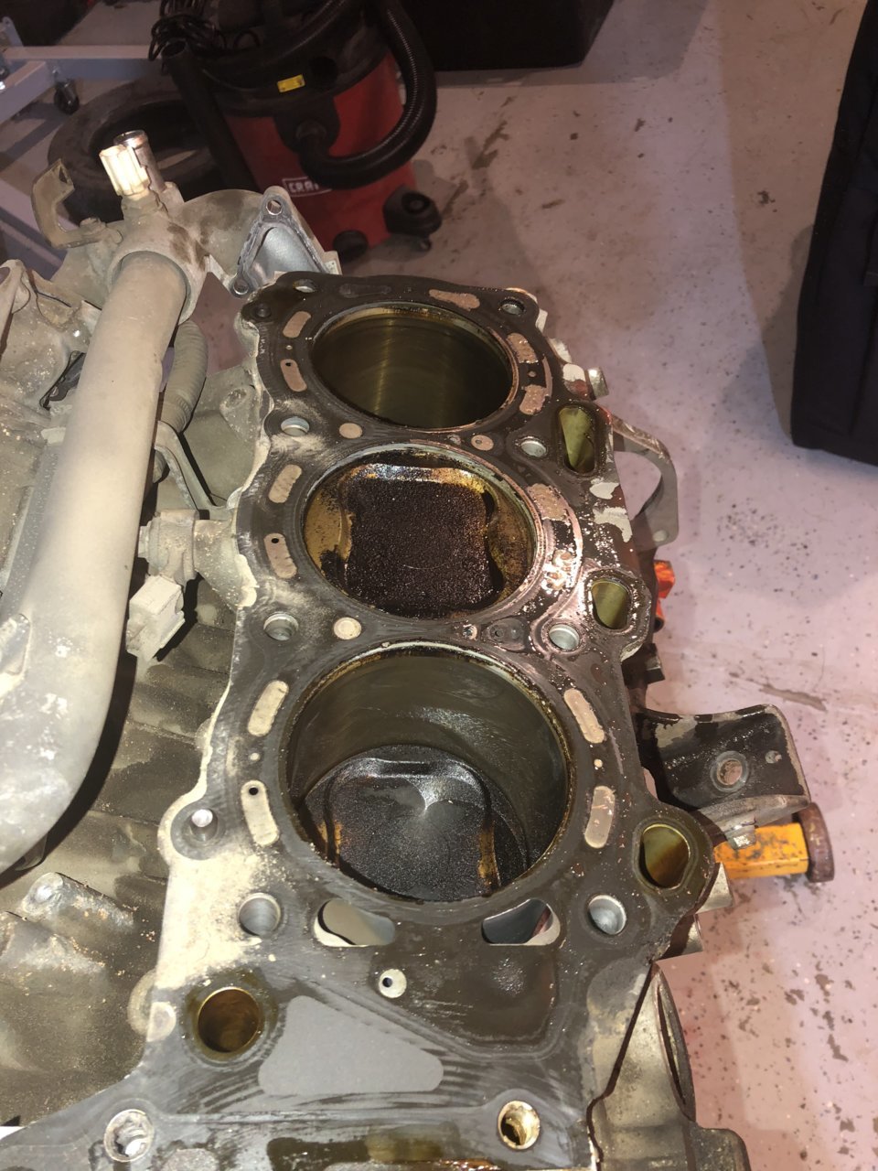

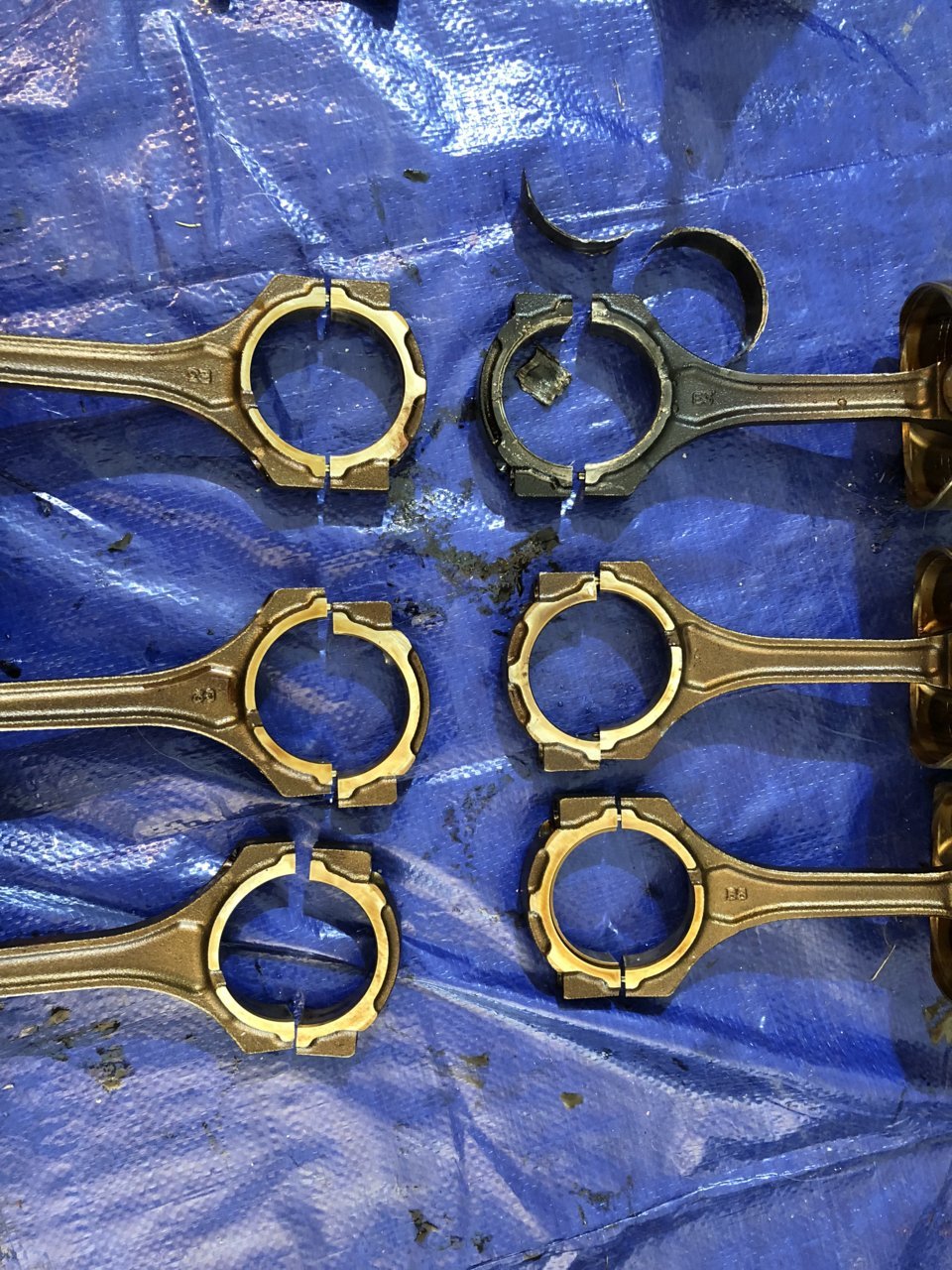

    Oh man I need to add to this. My current 1grfe has 126k miles and needs head work. Shop says it’s a damaged valve guide and a blown headgasket. I have two other 1grfes in my garage right now. One spun a bearing at 125k and the other blew a head gasket at 130k miles. I took the heads off the spin bearing motor and the heads off the headgasket motor and taking them to machine shop tomorrow morning for inspection. I’ll be pulling the heads on my truck for further diagnostics most likely tomorrow afternoon.
    Picture of the connecting rods from the bad bearing 1grfe.
    And a pic of the headgasket block

    What year model is the one in your truck?
