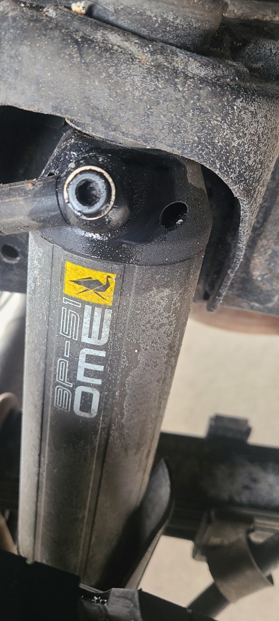

  2. Feb 13, 2021 at 12:38 PM
    #42
    Jose_Dirte
    Jose_Dirte Life's a garden, dig it
    Dec 12, 2018
    #275687
    660
    Joey
    Green Acres, CO
    A Tacoma, just like everybody else...
    Son of a...
    Oh well, I'm sure ARB will take care of me, they always have in the past.
    Really picked the perfect time to fail since I'm going to be swapping out the leaf springs from medium to heavy any day now.

  4. Feb 13, 2021 at 1:25 PM
    #44
    Jose_Dirte
    Dec 12, 2018
    #275687
    660
    Joey
    Green Acres, CO
    I get what your saying but there are no signs of the hose mount making contact with the shock mount (I have seen where people have had contact and caused a leak).
    Could have something to do with how cold it is in Denver right now or just a bad seal in my situation.

  6. Feb 13, 2021 at 4:31 PM
    #46
    Juforrest
    Juforrest [OP] Dumb!
    Nov 23, 2015
    #170434
    5,946
    Justin
    Seattle
    Reformed Taco driver in a GX460
    I really think the oil they use doesn’t agree with cold weather.
