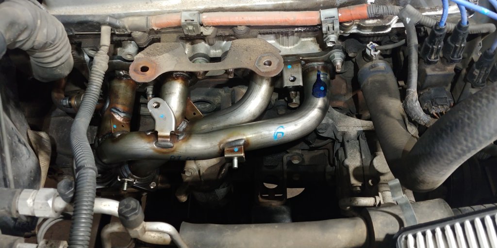

    I did one in mine after my stock cast manifold basically broke in half. Likely yours has been broken for a little while like mine was.
    No true dyno results, but at 8000' where I was living at the time, I felt like it had a little better throttle response, fuel economy bumped up around 1 mpg as well this was when I was much more stock. It's a much better swap than putting the cast style of header in but I wouldn't claim it adds tons of power. It seemed to have a touch more torque going over the mountain passes from what I remember.
    My factory one was cracked all but about an inch. They normally don't look too bad until you remove them.

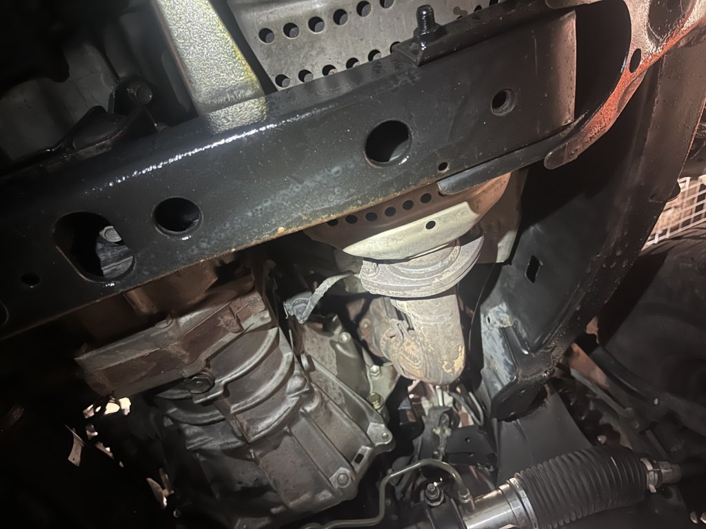

    May take you up on that, I just got under my truck and realized I only have a single cat since my truck wasn’t a CA until this past May so must have been the federal version.

    I believe that setup is drop in compatible with the mini header, I think the header is the same no matter what your cat arrangement is.

    It does drop right in - about as easy as it goes.

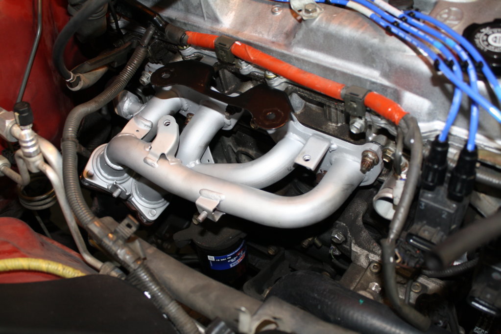

    2002 5-lug
    I’ve done it twice. Straight swap on both a 97 & 00 model. Not sure of any difference in performance.IMG_0113.jpg

    nice! beats a shitty cast iron - pulled mine today and located a few different small cracks aside from the big one I saw. What kind of coating did you paint it with?
