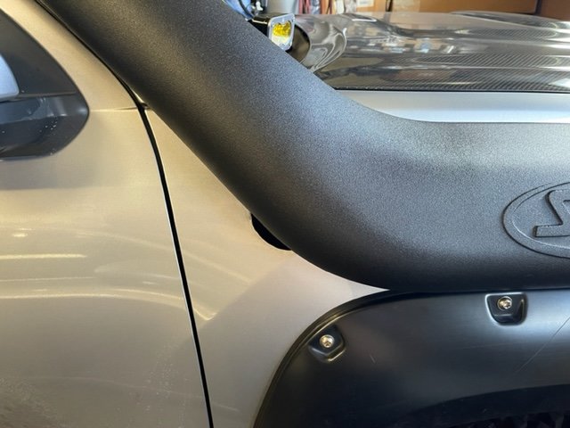

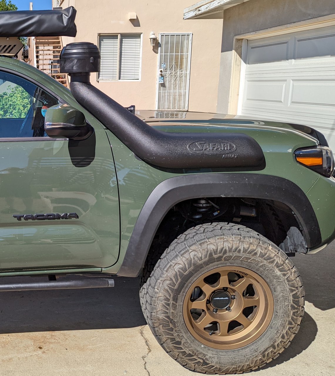

    If anyone is wondering if the Safari snorkel will cover the hole from this shit uptake snorkel it mostly does, but not completely. There's also 1 fastener point that you can't use on the safari because it's right in the middle of that hole. I ended up using a sticker to cover that open section. The safari snorkel definitely was designed properly. I'm getting equivalent airflow to the stock intake.

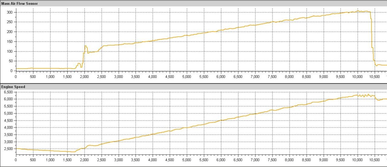

    As what safari has been saying but at speed due to air ram effect I wonder how this will look like

    That graph is a 2nd gear WOT pull I did on the street. Of all the runs (on the street) I’ve done so far with the safari snorkel the highest number I’ve seen is 318 g/sec. If I remember correctly I think the highest I’ve seen with the stock intake was 315 g/sec. This is with the 87mm pulley on the supercharger.

    Thanks .

    So against the advice in this thread, i installed the uptop snorkel and its pretty bad. Lost nearly 3 mpg and really struggles in acceleration and power. I have kdmax pro xtra torque tune and with uptop snorkel its worse than stock ecu/engine. I emailed uptop and mailed back the snorkel for full refund minus $50 shipping. Installed ARB snorkel which does not cover the hole made for the uptop snorkel as sk808 said but i put a piece of door edge trim around it and it covers it pretty well.
