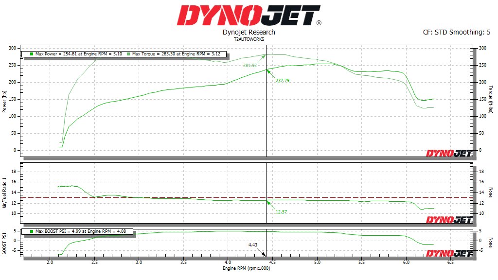

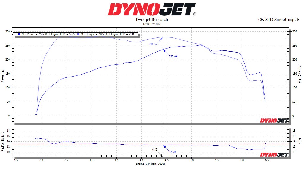

    Just got back from the dyno runs. Here are the data sheets. If you have this snorkel and supercharger or turbo, I'd like to hear your comments.

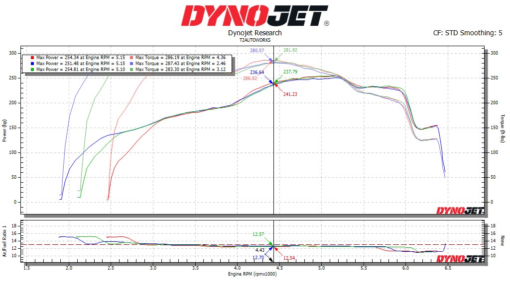

    This is 3 of 3 pulls and a combined chart. Very identical.

    No. Each pull (3 of them) has their own color. The upper line is the torque and the lower one is the hp. So for each pull, it's the same color. These were with the test snorkel fully piped.

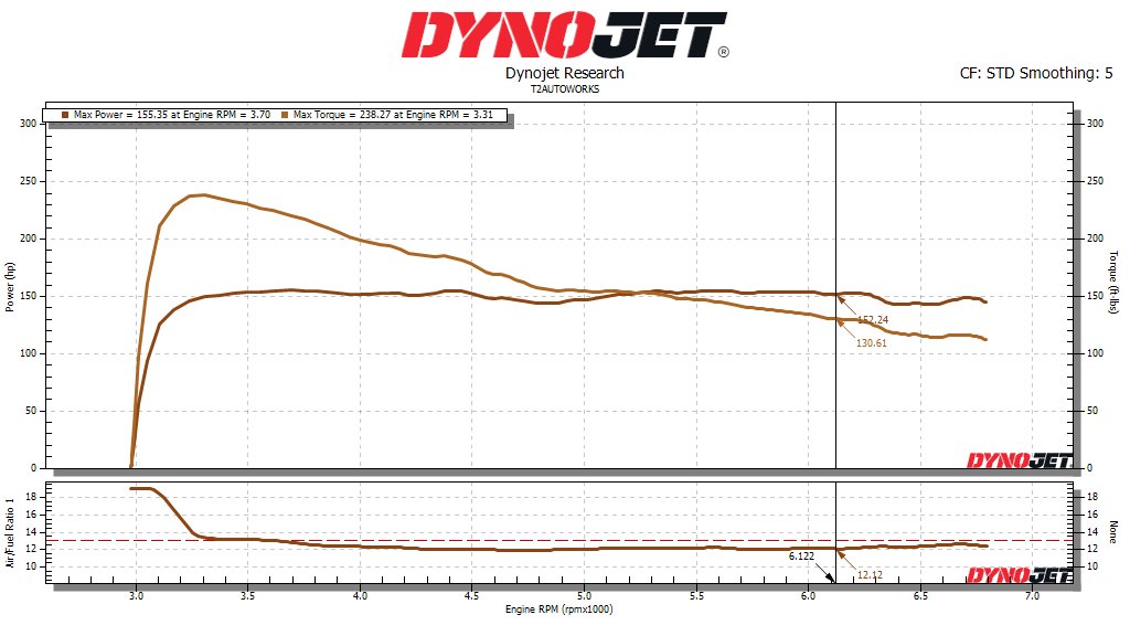

    The previous snorkel produced (as sold) produces this dyno chart below. Obviously it seriously constrains the engine, but way more when it's boosted like ours are. I'll post up what my baseline was without any snorkel to help.

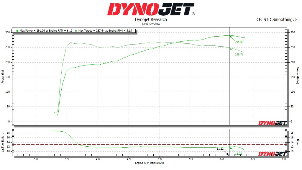

    To give you a baseline, this dyno chart is without anything connected to the airbox (no snorkel). I did have an issue with this and that is that this particular dyno is brand new and it consistently showed lower hp and torque across the board with other vehicles (approx. 10% according to tech). And, I believe him because he is a tuner and he knows his sh!t. lol. Also, this was a test tune, so lot's of variable, but close enough for our situation I think.

    yes, I agree. I think it would actually be even better if the tubing were increased also in the fender (the fender tube remained the same).

    Yeah definitely improved, but still looks like it needs more flow. Are you able to data log? The MAF reading at WOT would confirm exactly how much airflow you’re getting. I think that’s a better data point than a dyno in this situation.
