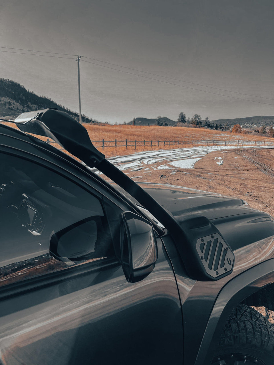

    It’s making 0 boost at WOT with this snorkel. I believe the bypass valve on the supercharger is not closing due to insufficient airflow.

    So I took the cover off and cut down my hose at the box. I resealed it with gasket maker and then drove it after it all cured. Final result is I'm getting regular boost now. This is again not scientific, but in comparison to not having a cover on the box and after cutting the hose elbow down with a utility knife. It drives identical at this current time.

    I did the same modification over the weekend and still ZERO boost. This snorkel is shit!! I contacted Uptop earlier last week and let them know about the airflow issue and asked them for airflow data. They still haven’t responded.
    I ran a quick test/datalog and compared it to one of my old datalogs with the stock intake and according to the MAF readings the snorkel is providing roughly 63% less airflow vs the stock intake.
    Snorkel max MAF reading: 155.84 g/sec @ 5303 RPM.
    Previous datalog at comparable RPM and throttle position was 254.03 g/sec @5296 RPM.
    both of these were at WOT.
    The runs weren’t identical/perfect conditions, but I don’t think that would make that much of a difference. That’s why I’m comparing at a comparable RPM and throttle position. Just a rough comparison.
    I’m looking forward to hearing from Uptop. I’d like to know what their test results were.

    Well yeah your engine is trying to breathe through a drinking straw...
    :bananadead:
    It looks cool as shit I'll give you that, but that is quite possibly the most restrictive intake in anything I've ever seen even comparing to stock.
    ARB actually delayed the release of their Safari snorkel for the Tacoma because they needed to rework it to provide more volume for the stock engine itself, as well as they wanted to provide no restrictions for supercharged applications.
    It's very very apparent that Uptop Overland's focus was purely aesthetics and I doubt they had a fluid engineer at all in development with this product.
    All for the gram, just show no go.
    Is the ARB ugly? Yeah, but it performs great. I actually gained 1 mpg with the Safari Snorkel.
