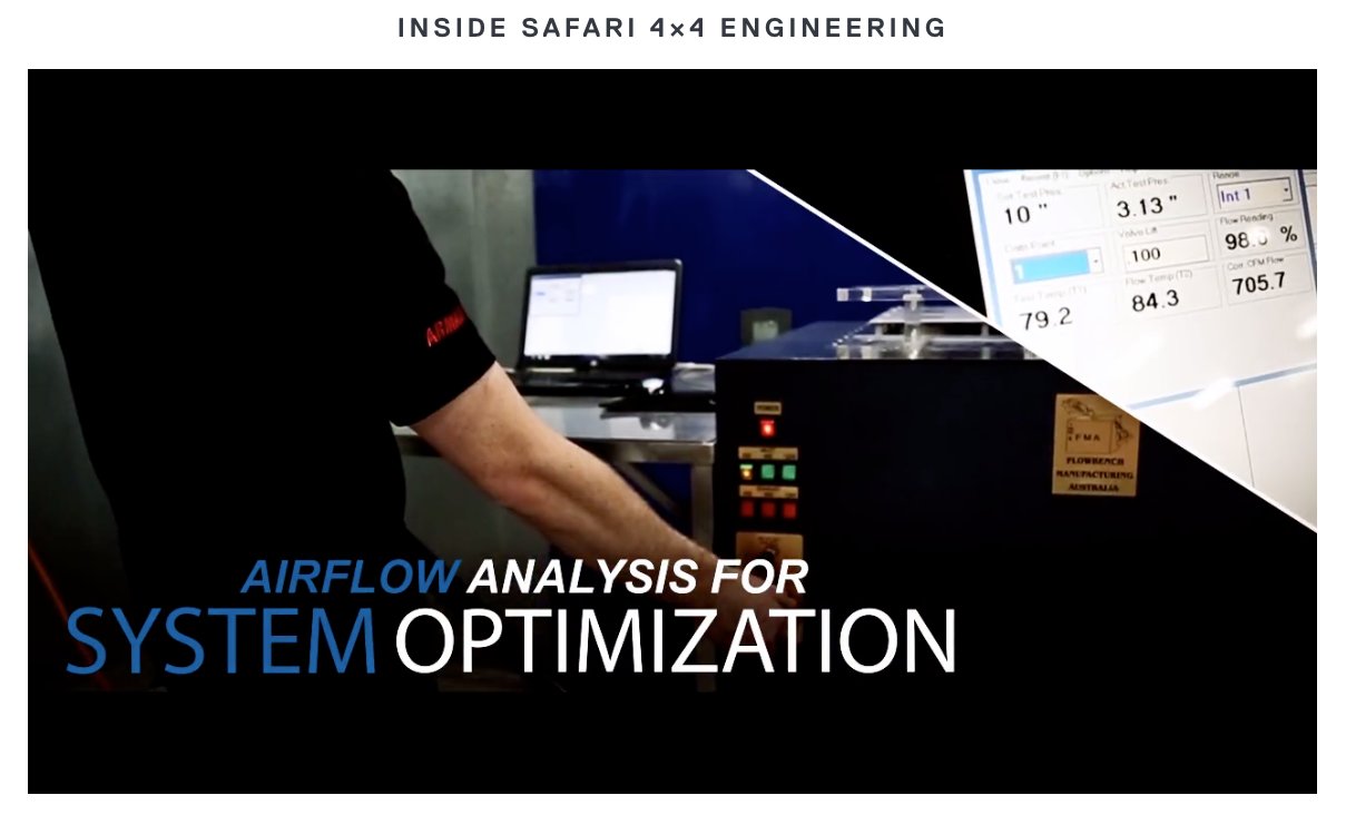

    2020 DCLB Off Road Premium in Slowsand
    https://arbusa.com/safari-snorkels/
    Doing the research to bring you the science!

    Would be nice to see the same CFM/AF data from Uptop (even if from a screenshot). I have not. However, I doubt anyone is actually testing this under SC applications. Maybe we need someone with a NA engine do a dyno run with it?

    https://arbusa.com/toyota-tacoma-2016-on/safari-snorkels/
    "Featuring the new ARMAX design, the new Toyota Tacoma snorkel for the 3rd generation model is the start of a new generation of raised air intakes from Safari Snorkel. Tested and verified on an airflow bench, each ARMAX design ensures that the airflow through the snorkel meets or exceeds that of the factory inlet design. This ensures that if the owner wishes to increase their engine’s performance (ECU, exhaust, forced induction), the snorkel will meet those needs while providing the cold, clean air that is a standard benefit from any Safari Snorkel model. The SS172HP ARMAX outperforms the CFM flow of other brand Tacoma application snorkels by 10%."
