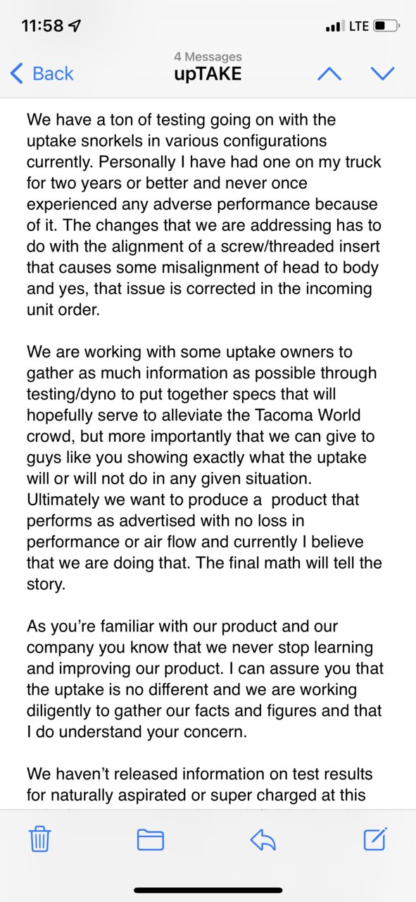

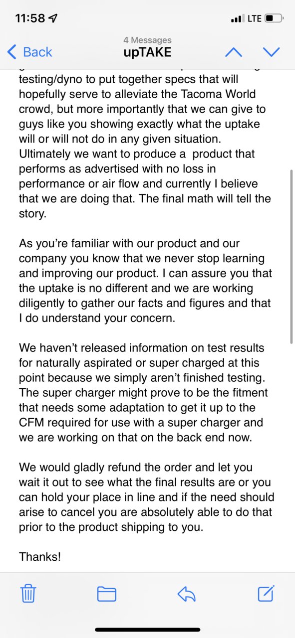

    Here is a response I got from them a week or so ago.

    Thanks for posting that, but that just sounds like bullshit to me. They’re not releasing data because the data looks like shit. They won’t even release airflow data from their testing during design. Probably because they don’t have any. He claims he’s been using it for 2 years without an issue, but yet he’s not even showing any airflow data even from their truck. That just tells me their hiding shit.
    At least they offered to cancel your order and give a refund.

    It's simple PR bull crap we hear the same every damn time from them as a "company". They are two steps away from being the media in my book. They stopped answering me awhile back when I pushed for the "data" they had, to be fair I got a bit frustrated on the phone towards the lady on the phone.
    If there was any testing done prior they would have data to show us they could easily provide it. The simple conclusion is there is no data and they are blowing a load of smoke up our asses. As I said earlier their "engineer" could have easily provided simulation testing for flow rates or data from their vehicles ECU. Where is this great engineer they are keeping hidden away?
    Multiple configurations? How are they changing the design with a molded plastic product. These take a long time to make most likely they are getting it done in China. This would be a huge overhead. This is a complete lie.
    There is zero details on the actual actions being taken with all their answers just evading the real answer.
    Well looks like I will just buy a new body panel while still being a grumpy old man about this ordeal. Could have spent that $1000 on cruise with a buffet that would have made me happier.

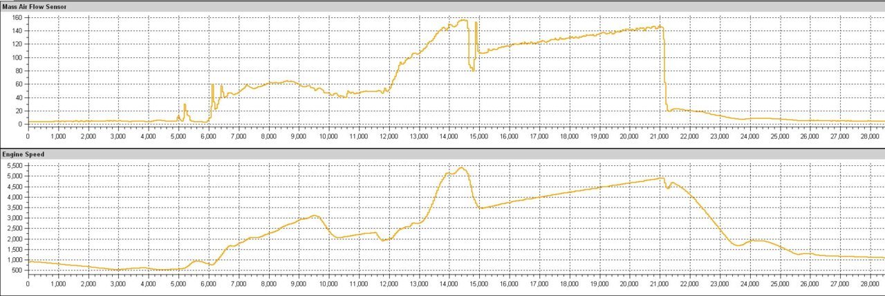

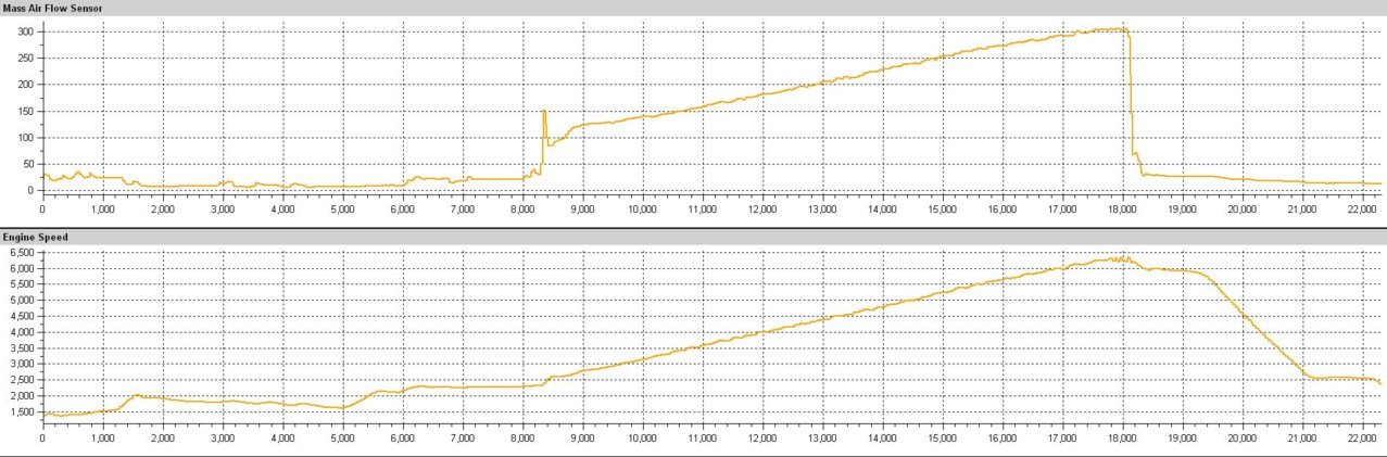

    The engine demands a certain amount of air during different scenarios. At idle you don't need much air at all. The engine needs the most air at full throttle. It doesn't matter how much air you try to push down that snorkel if there's not enough volume due to a choke point then it's not going to supply enough air for the engine. Here's a MAF and RPM reading I took when I first ran this shit snorkel. This is a full throttle pull in "D" and max airflow is only 155.84 g/sec @5303 RPM.
    Now compare that to this graph below with the stock intake (without this shit snorkel). This is also full throttle. Not the exact same condition and was tested on a different day, but the difference is substantial. 254.03 g/sec @ the similar RPM range of 5300.
    Now you tell me pushing air down this snorkel makes a difference when there's a choke point. When I cut down the cone on the inside of that access box it improved the airflow about 10 g/sec. I think the choke point is the snorkel tube, it's just too skinny.
    Like I said, it's your money. If you want to buy it go for it. If you think I'm full of shit that's fine to everyone has a right to their opinion and I don't really care :notsure: I'm just providing info on what I'm seeing.
    I've been meaning to do another comparative test with the exact same conditions, but just haven't had time. Besides I think it'll be a complete waste of my time because the data will still look like shit and Uptop isn't going to acknowledge it anyway.
    Edit: by the way, it’s not about speed, it’s about acceleration. If you’re light on the throttle you can still build up speed without an issue. It’s when you full throttle to get to that target speed is when it chokes.

    Dude, those graphs I posted are logs I took on the street. That’s not data from dyno.
    yes I’m supercharged, but the airflow is what it is. That’s not horse power numbers. Those are actual airflow measurements from the MAF sensor on the intake pipe. If anything those numbers would probably look worse on an NA since the engine is pulling less air.
