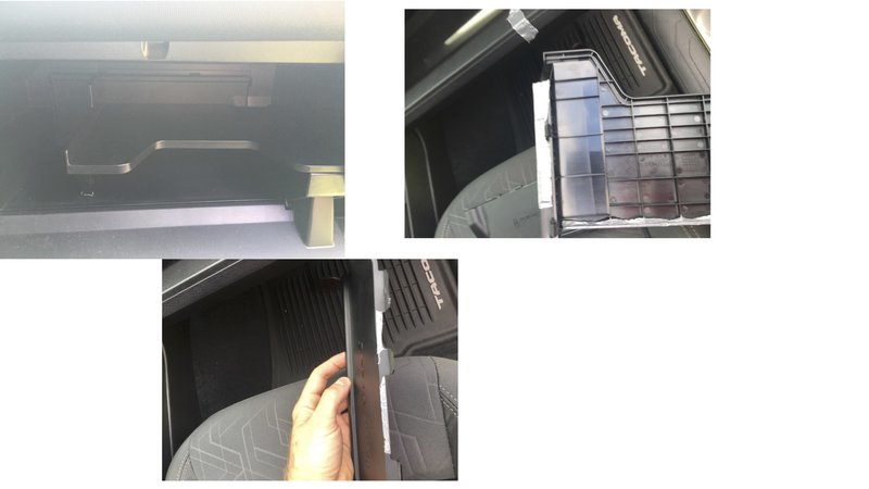

    So I had the rattle problem as well. Same sound as @Haikin posted in his video.
    Mostly over bumpy roads which is everywhere in Hawaii. I removed everything from the glove box and it still rattled although slightly less. I removed the shelf and the cover to the cabin air filter and the noise stopped.
    The rattle issue in my truck was plastic on plastic between the shelf and cabin air filter cover. with any added weight on the shelf the noise appeared louder.
    My temporary fix until I can get some felt tape was to put 100 mph tape (duct tape) on flat surfaces with potential plastic on plastic rubbing. It's not pretty but once installed you can't see the tape. This did two things; stopped plastic on plastic rubbing and allowed for a tighter fit of the shelf and cover.

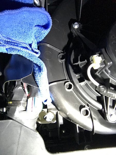

    So I had the annoying rattle noise on the passenger side. Thanks to the forum, it turned out to be the A pillar and speaker issue.
    But! Once I fixed that, I noticed I had another rattle/buzz/squeak. Been trying to figure this one out for a while now. Tried the shelf remove/tape options, removed the cover for the access to the cabin air filter. Tried making the glove box close tighter. All sorts of experiments.
    Today, I think I finally figured it out. Underneath the glove box is a bundle of wires wrapped in plastic. It is jammed up against what I guess is the blower for the heat/cooling. So today I put a microfibre towel in between the two. Drove around for a while on every type of road, gravel, highway, bumpy roads. No noise issues. So hopefully I fixed it!

    that's where my noise came from too. I shoved some foam up there like your cloth and it worked!
