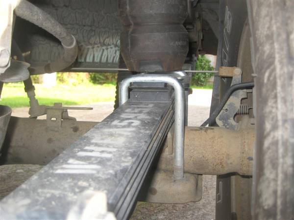

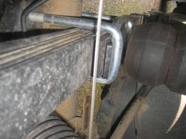

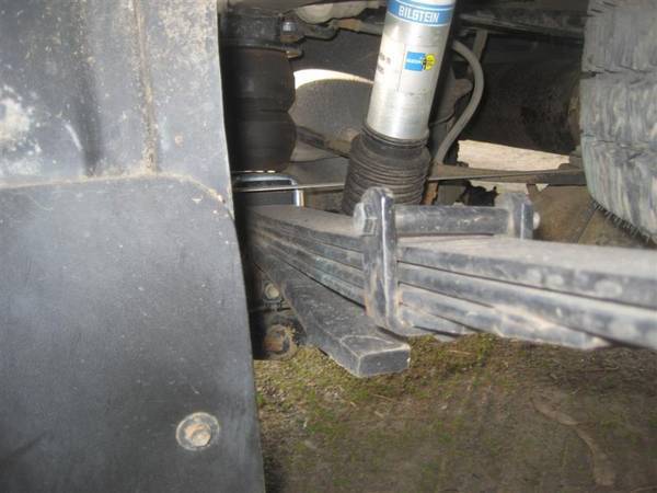

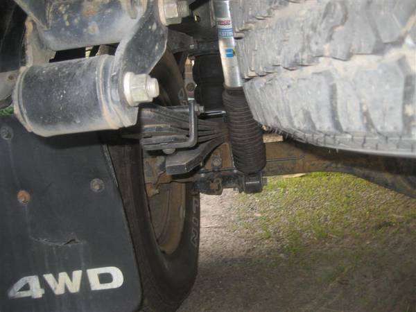

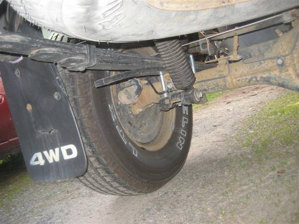

    Yep, stock coils upfront. Everything except leafs, shocks and the rear bumpstops is stock.
    Here's some images. I put 1/2" blocks under the tops of the U-bolts to help achieve the correct spacing for the Timbrens.

    These pictures are great, thanks.
    Intersting lack of arch, but I guess this is pretty normal with the stock design of attachment points/angle and only a single shackle in the rear.
    $1,000,000 question: did this fix, or significantly reduce, axle wrap for you?

    These images are with the Snugtop on which weighs maybe 150lbs ?? and you're right that there isn't a lot of arch to them.
    I guess it was an axle wrap issue I had before installing these leafs. I would get a pretty significant shudder when shifting from 4th to 5th gear unless I gave it just the right amount of gas when releasing the clutch. Now I only get the shudder under certain conditions like shifting too fast from 4th to 5th and not giving it any gas when letting the clutch out. I originally got the new leafs to increase my load capacity while at the same time maintaining a smooth empty ride. Fixing the shudder was a very nice fringe benefit. I notice that right after I pump lube into the driveshaft slip joint there is absolutely no shudder no matter how I shift gears.
    If you do order these 5 leaf packs Wheelers recommends the longer U-bolts but I think I could have gotten by with the stock ones but since I added 1/2 blocks under the top of the U-bolts as part of the Timbren install the increased length was necessary. Before adding the blocks there was a lot of extra thread sticking out at the bottom. I know many people say to replace U-bolts but the stock ones are a better quality than the replacement ones. I'd order the longer U-bolts to have on hand but don't open the bag until you're sure you'll use them that way you should be able to return them for a refund.
    Before removing the stock leafs try to take some measurements or make some marks to use as reference points so that your axle will be straight after installing the new leafs or have a 4 wheel alignment done latter.
    Remember to apply torque evenly in a pattern, first get the bolts to say 20 lbs torque then 40 lbs so on until you get the correct torque and recheck them after a few miles and again after maybe 50 miles and then 100 miles.
