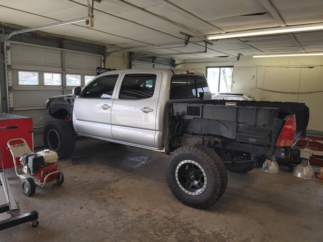

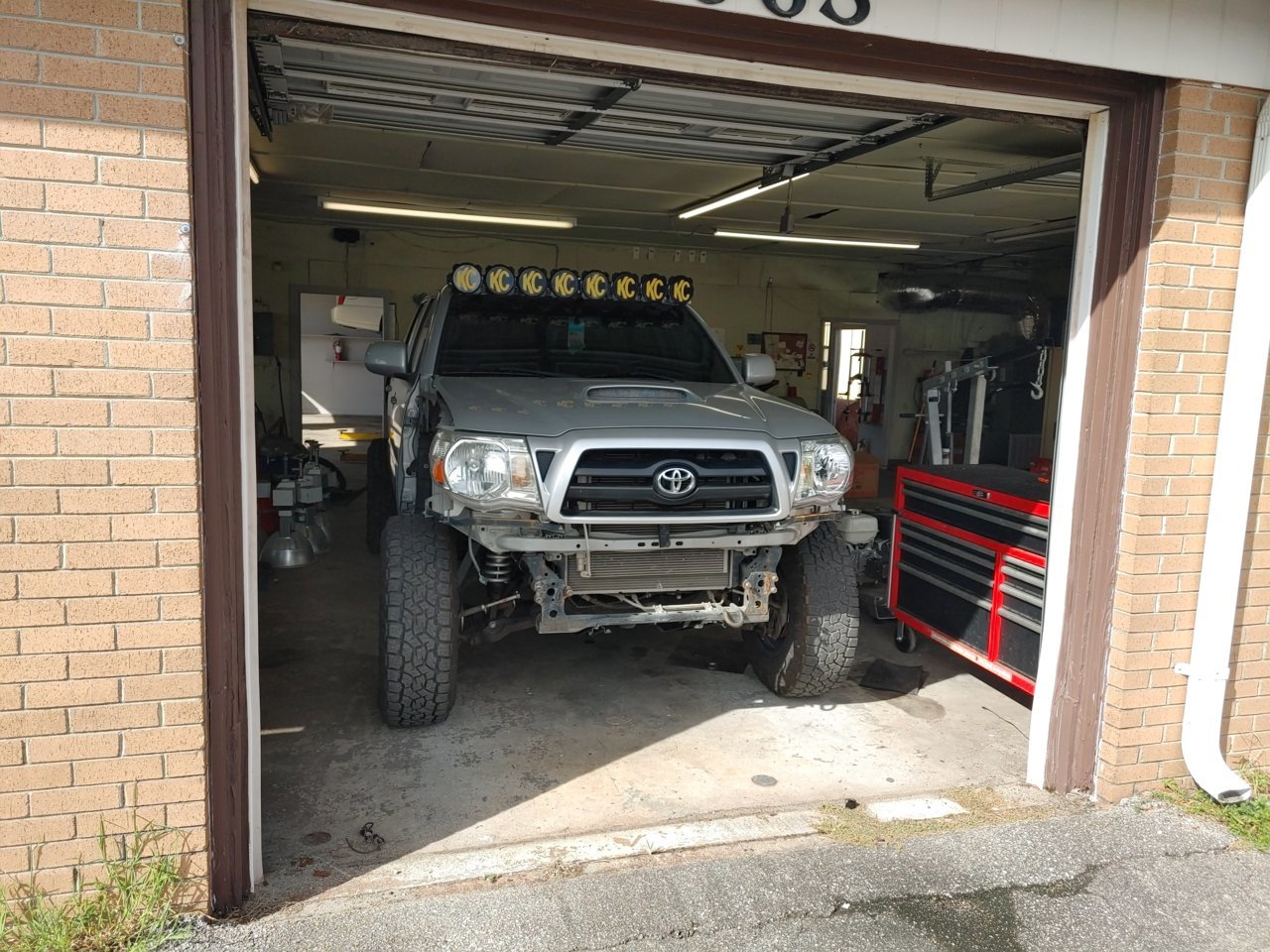

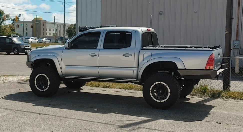

    Thanks buddy. Those bumpers are actually gone and im awaiting some mcneil fiberglass fenders as well as some tube bumpers from calmini.

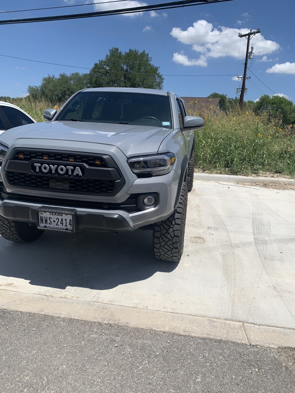

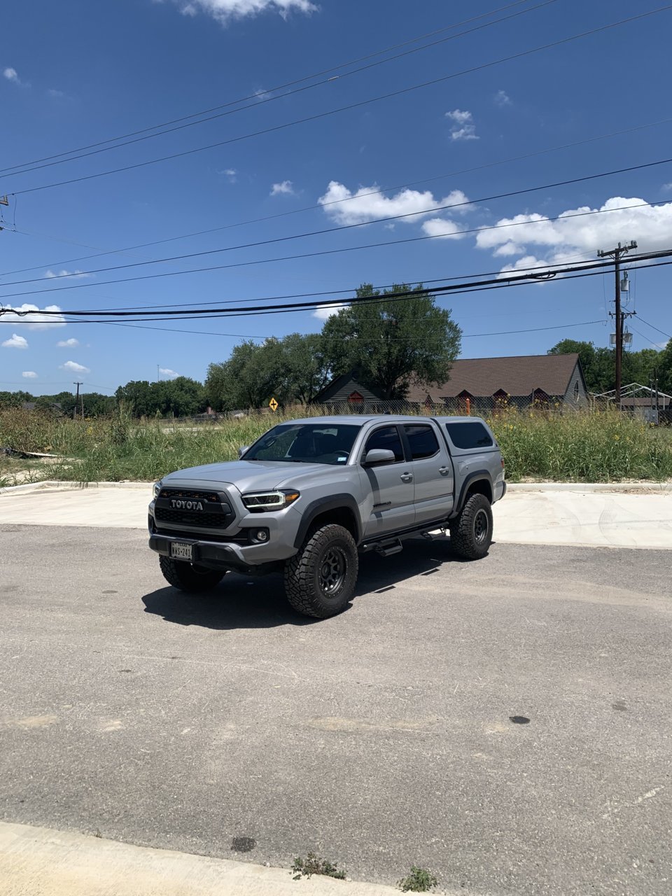

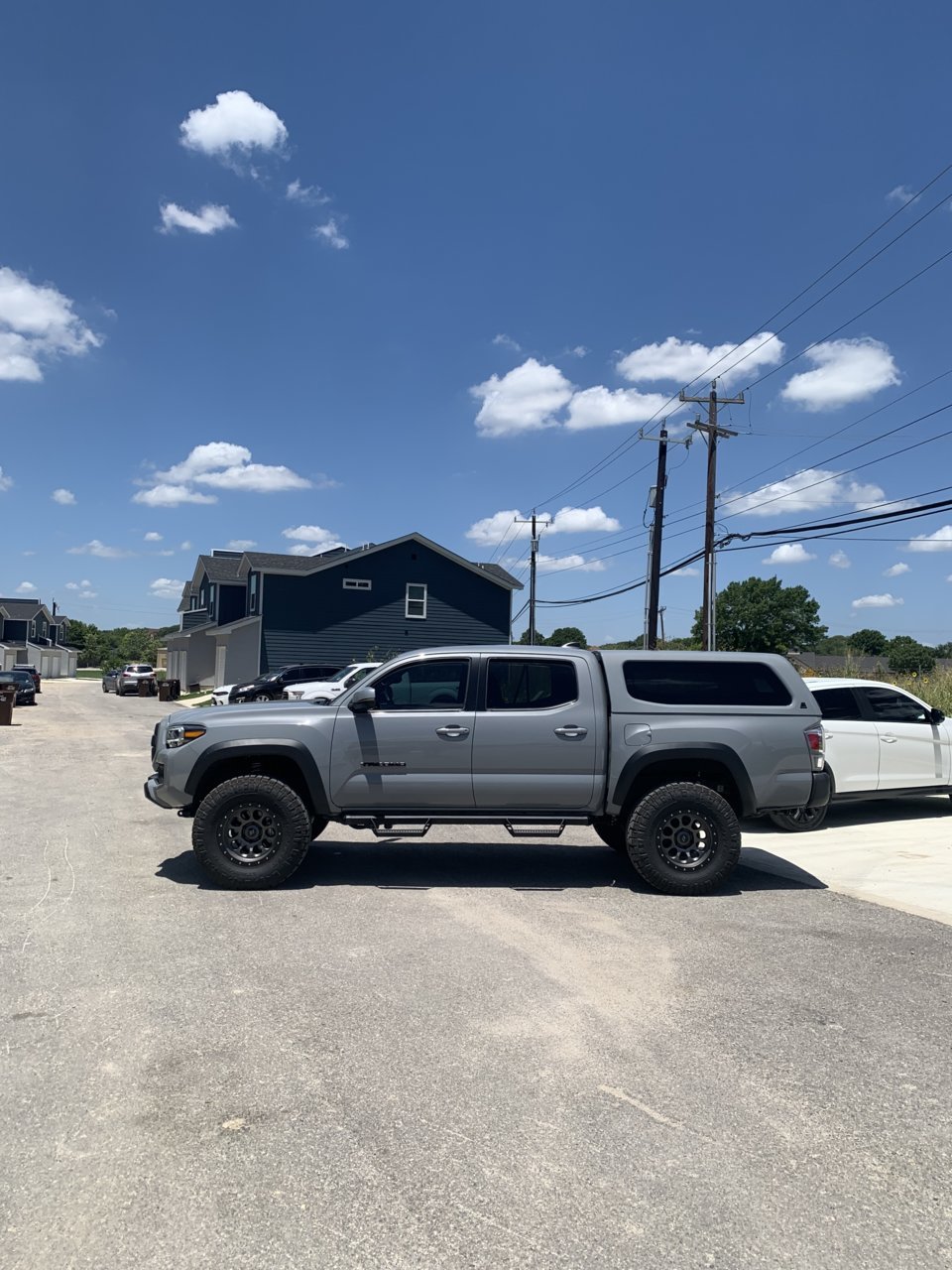

    285/75R17 RGs. ~2in lift with eibach pro lift up front, and icon multi rate rtx leaf springs set in option 2 paired with fox 2.0 on the rear.
    started with just a Cab mount chop. had minimal rubbing on the inside of the front wheel well on the plastic, that got even worse after the alignment. used a heat gun and molded it in and i haven’t rubbed since then.

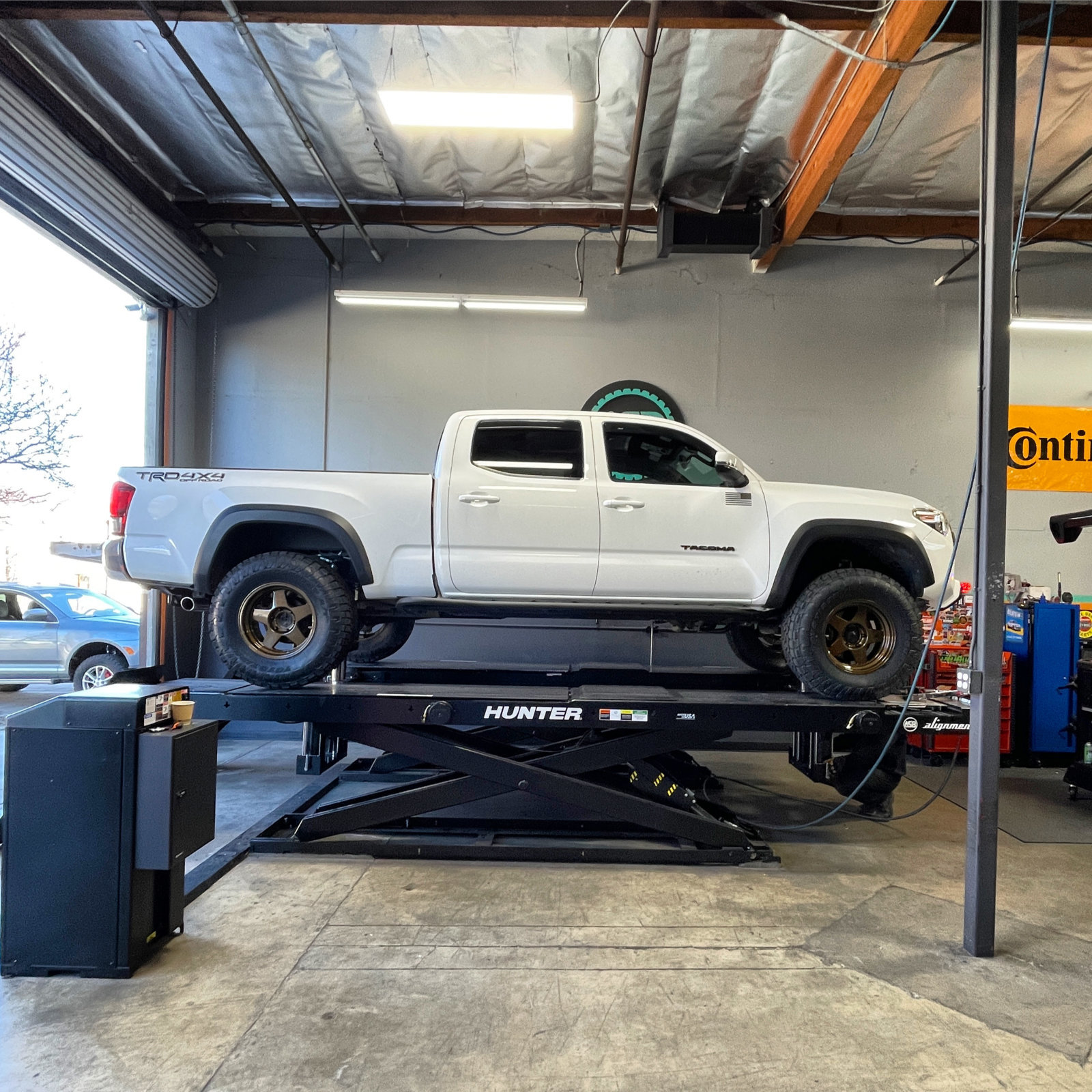

    Fox DSC 3.0" lift
    Add a leaf approx 1.75” lift rear
    Camburg UCAs
    SCS Gen5 17x8.5 -10mm offset
    285/75/17 Toyo AT3s
    CMC, pinch weld folded and trimmed bottom of metal fender

    it honestly drives the same as when stock. This 3.5 engine is notorious of shifting too soon which prevents it from staying at the peak power band.

    Looks great! what wheels are those?

    They are Stealth Custom Series Gen5 in gloss dark bronze.
