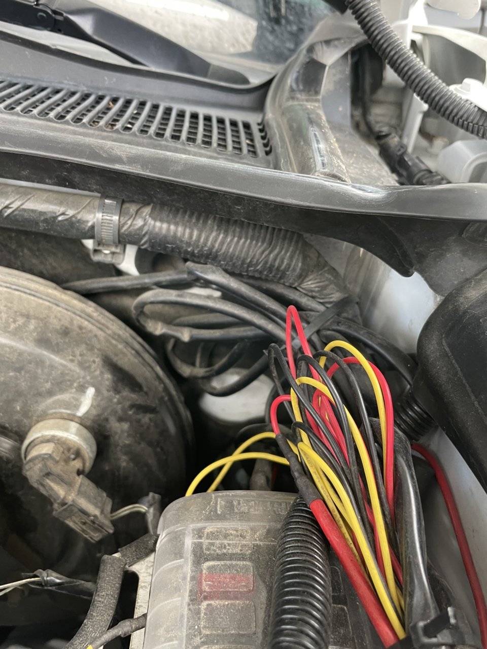

    that’s fair, the best way is to use a screw driver to pull back the main harness boot and then feed the wire through. Many use the clothes hanger push or pull method and it’s okay and kinda sketchy if you miss.
    screw driver to pull the boot back and feed the wire through. There is also a spot in the firewall you can drill through that has nothing behind it and then can feed the wire through. The area is the white circle in my photo on my firewall

    Is it possible to show me this in a video, I’m more of a visual learner lol, appreciate all the advise

    I can tomorrow, it’s too dark to see right now. There is another option if you plan on running more accessories; a switch panel like Aux beam or switch pro. Then you have to only run the switch panel through the firewall once and then everything else hooks up under the hood
