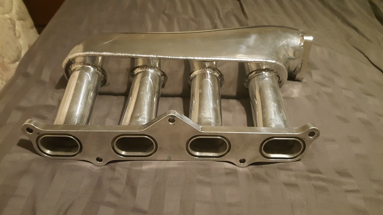

    I can ask, but in all honesty, it would be quicker for me to get you a trace of the flange to transfer over to a fresh plate and go from there.
    As you can see, the gaskets basically Orings. Should be a nice, positive seal, just be weary of how you tighten the manifold down to avoid squeezing the rubber put of its home

    Yeah, @MrCrowntown said that the 2tr timing cover is thicker than the 2/3rz one but it won't be that much. You wouldn't have to redo the nose drive runner. An aluminum spacer for the pulley should do the trick. I think the only fab work required is replacing the 2/3rz flange with one that fits the 2tr. That would have to be custom made... or not?

    Yes, some accurate measurements and orientation would be OUTSTANDING

    I second this! But even better if I can just buy that flange and weld it on and be done with it
