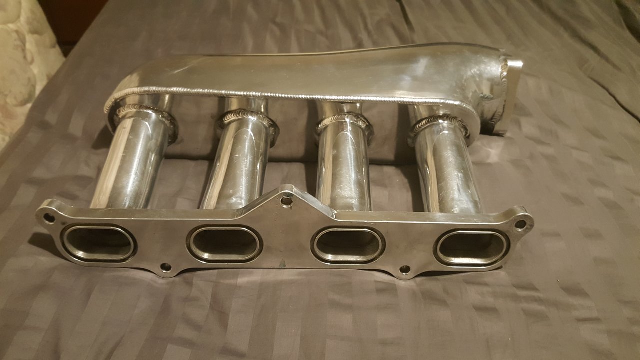

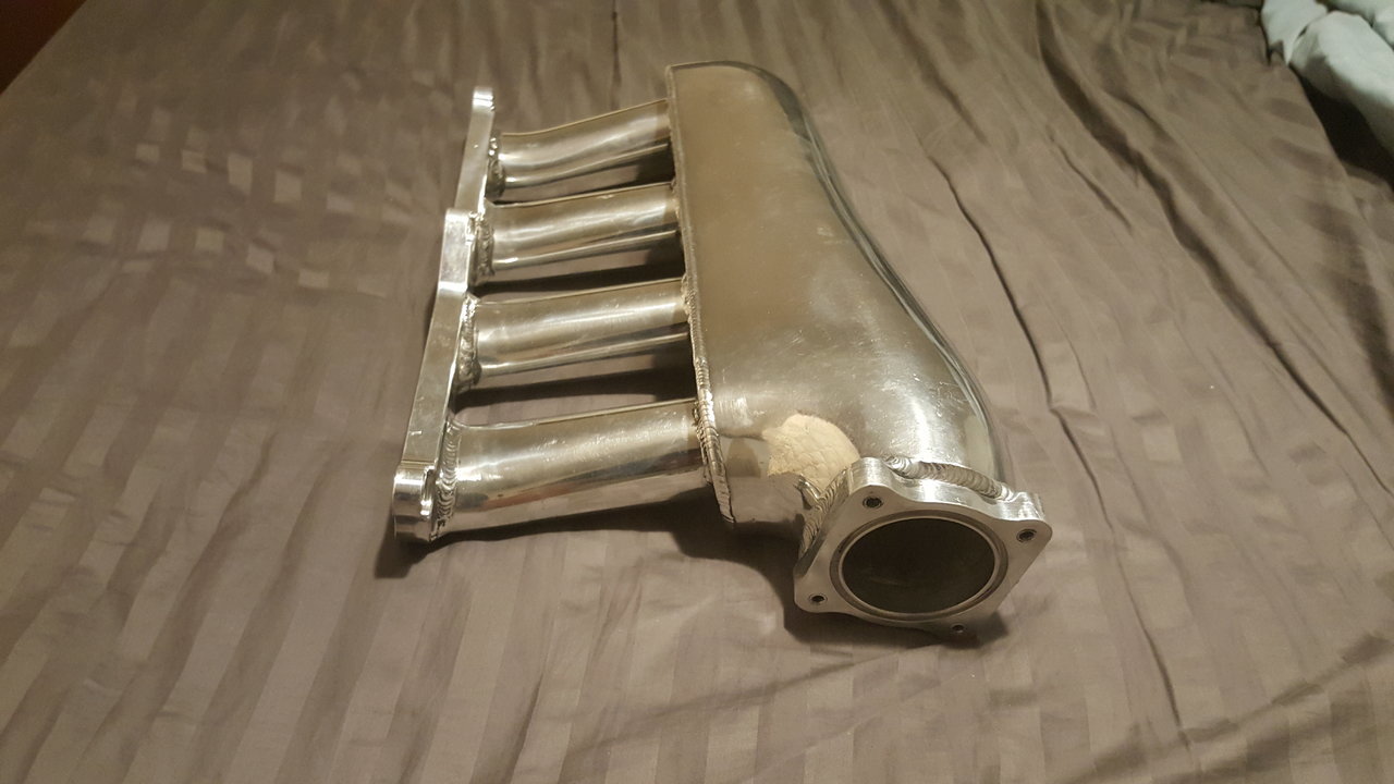

    @KirkRio got the oz boost kit and replaced everything but the manifold, i think @dirtdigginjoe contacted the maker of the mani and is getting one shipped to him for ~$400 and seems like he is in decent communications and might be able to get a "bulk order" if enough interest is shown.

    700 from a guy in thailand? Whats his name?
    Im on the 2tr Thailand FB and haven't seen anyone with those kind of numbers yet?

    Dunno off hand, all I remember is seeing a massive custom intake manifold and a dyno that was like 698 or something. :eek: Maybe it was New Zealand or some other place where they play with 2TRs more than the US.

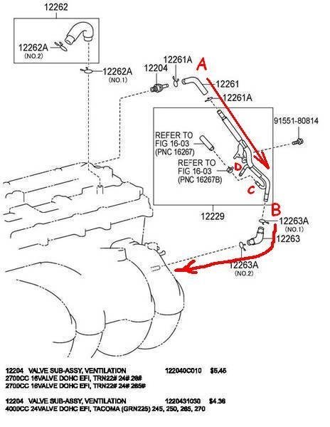

    Diagram on 2trfe:
    06F4CA38-E841-4687-A95C-AD77A78A2756-533-000001560304E907.jpg 12262 is the entry of air into the valve cover, I suppose it could be replaced with a filter.
    Call me a tree hugger but venting PCV to atmosphere even with catch can is pollution and I won't do it. (It would also fail inspection in CA)
    My plan for the supercharger install (whenever that may materialize) is to add a catch can somewhere along arrow A. I'm am unsure of what all that crap labeled C and D in box 12229 is. Does anybody know?
    So the cautious approach would be to just interrupt hose #12261 with a catch can but still hook up hose #12263 to the intake port on the supercharger.
    Or can I safely go from the catch can to the intake port and bypass all that jazz labeled C and D?

    You'd be in for a surprise if you popped C or D's hoses off.:eek: It's a coolant passage for the throttle body.;)
    I still haven't figured out whether or not it is easier to put the can on B or A. Using A straight off the PCV would require your plumbing to make a 90 degree turn pretty quickly, and if your can was on the driver's side it would have to make a 180 turn on the return.
    On the flip side, B would be much easier to route hoses to on the driver's side, but if you've looked at where those hoses are they are a ballbuster to actually get to for install.
    Mixing A and B (hose off PCB, return into intake mani) would be the worst of both worlds.:annoyed:

    Wtf? A coolant passage for the TB? What does coolant have to do with the PCV system? It must be a closed loop then otherwise you'd be mixing oil and coolant. Maybe it's adjoining to cool the air before it re-enters the manifold? If so the catch can would serve the same purpose so it should be fine to go A -> catch can -> manifold
