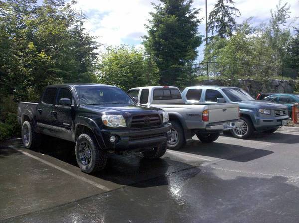

    It's not exactly what you're looking for because I have 5100's in the front set at 1.75", but I am running 285/60/18's on stock rear suspension here, so just imagine the front a little lower:
    PS: I was running that tire on stock suspension with no rubbing issues once the front mud flaps were removed.

    I know of a couple people, including myself, that ran that setup on bone stock suspension. With the mud flaps removed, there was nothing I could do TO make them rub.

    Man, why does everybody keep saying this? I PERSONALLY ran this setup on stock suspension and DID NOT rub EVER.
    Also, you can't compare a 285/60/18 to a 285/75/16, there's almost a 1.5" size differential.
    285/60/18 = 31.46
    285/75/16 = 32.83
