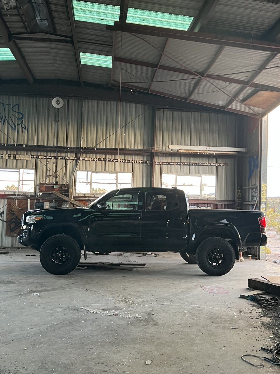

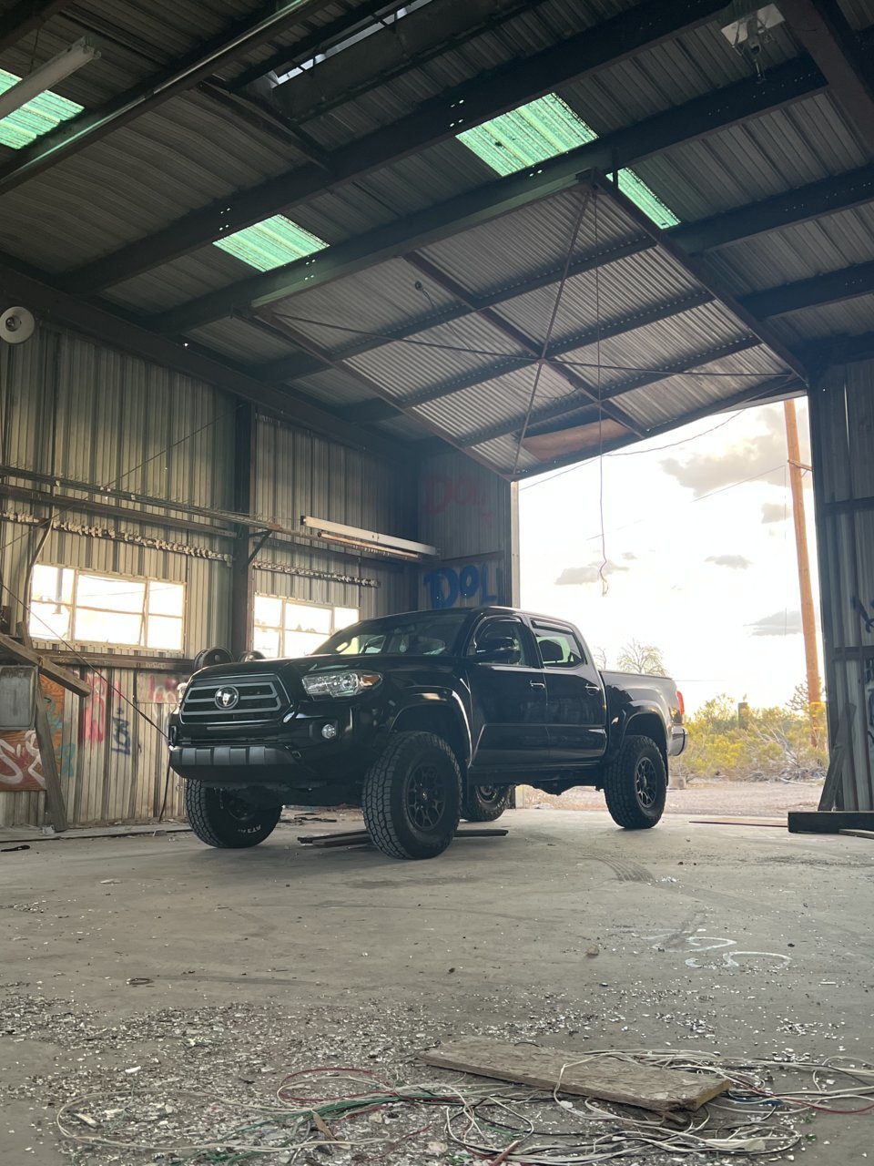

    ZooliganLo
    ZooliganLo [OP] Well-Known Member
    Nov 1, 2020
    #345563
    56
    Carlo
    2020 sr5 4x4
    Thanks!! I used oem sr5 16x7 +25 wheel . I also have 1 inch bora spacers(-25). Got it to sit at a 0 offset with this combination.

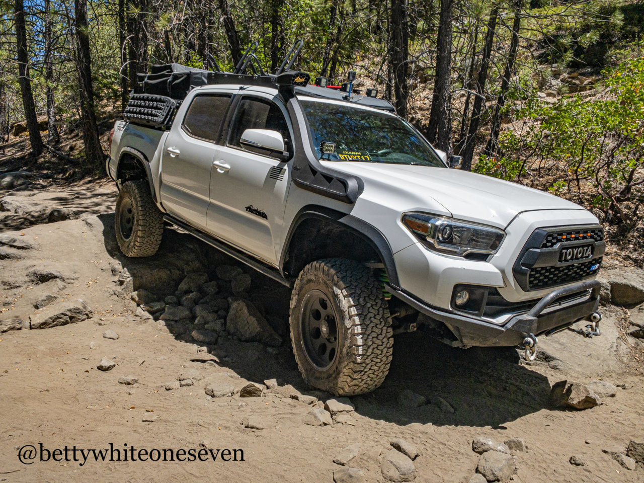

    3.5" IronMan4x4 Suspension Lift Kit. #3" BFGoodrich tires on 17" Series 60 Vintage Matte Black wheels. Apex Fabrications rock sliders. Southern Style OffRoad Stage 2 Slimline Hybrid bumper. Hooke Road roof rack. KFFab Voodoo Max Modular 13" bed rack.
    - Lifetime average = 14.6. Highway 17. City 10
    - You'll always want to go bigger, I've done 265/70-16 -> 265/75-16 -> 285/70-17 -> 295/70-17 -> 35/12.5-17 tomorrow. had the truck 3 years, first words out of my mouth was "2" lift at max, and 265/75s and I'm happy". Boy was I wrong. Lol.
    - With nonadjustable UCAs, I rubbed on the cab mount. Cab Mount Relocation took care of that. Pinch welds beat back and fender liners tossed.
    - I personally haven't noticed, I drive slow anyways but I've never been looking for more power on the trails.
    I think you'll be fine with 285s. At least a cab mount chop would probably be your best bet for no rubbing issues.

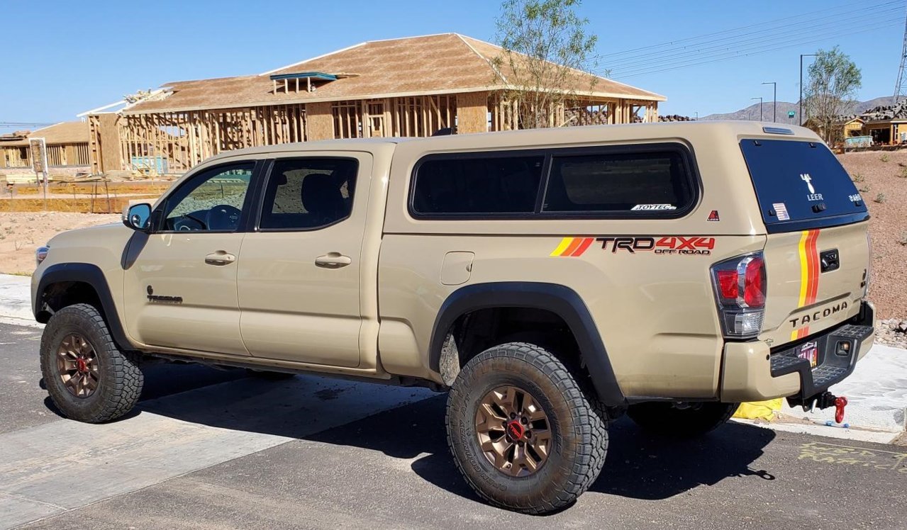

    West of West Phoenix
    20 Tacoma DCLB TRDOR Desert Sand
    2.5" lift w/33" tires, 10K Winch & bumper, camper shell
    I have Toyo AT3's, 285/75/16's on OEM rims, 1.25" spacers, SPC uca's, 2.5" front & 3" rear lift, cab mount chop. No rubbing...ever. Oh yeah and KDMax tune for sure!
    I'm an old guy and, I've had 35" tires once and all others have been 33" for moderate off-roading (fishing/camping/hunting) not a "serious" off roader here. IMHO, 33's will get you into and out of a LOT of places. Further, the difficulty/cost curve goes up SIGNIFICANTLY on these trucks over 33" . So, for a modest investment, I have a truck that looks super cool, rides great, goes anywhere I want to go, is 100% reliable, is juuuuuust powerful enough, and gets crappy mileage (16-17 to and from work). I'm mostly happy...for an old guy. :cheers:

    ZooliganLo
    Nov 1, 2020
    #345563
    56
    Carlo
    2020 sr5 4x4
    No, it’s not stock, for the tire fitment I had to do a 2 inch lift in the front 2 inch in the back with add a leaf , I have SPA upper control arms at 2° caster … once everything installed I did in alignment with a 3.7° caster so I don’t have to remove my mudguards or do a cab mount chop.
    absolutely no rubbing on full lock or off-road
