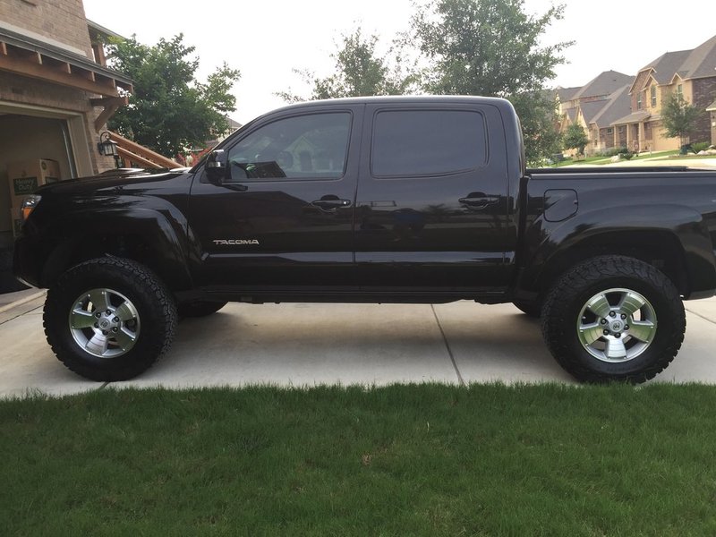

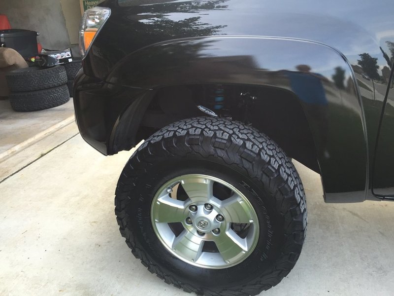

    Thanks, man. It rides as well as it did when it was stock, no noticeable difference. As far as trimming goes, there was none involved. Everything fits perfectly and looks great.

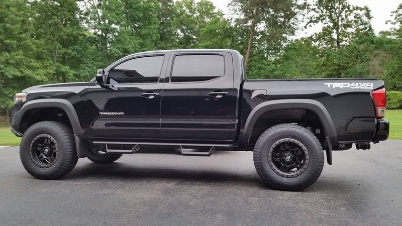

    I have the same lift with pro comp ucas and am running TRD Sport stock wheels with BFG KO2 285/70/17. Had to put 1.25 spidertrax spacers on to clear the ucas. Plastic trimming was needed to avoid rubbing. Absolutely no rubbing and no CMC needed.

    Pretty sure the second gens sat lower than the third gen though, so the trimming makes sense.
    I had a 3/1 revtek kit on my second gen and it rubbed like a mofo in reverse. No rubbing going forward though.

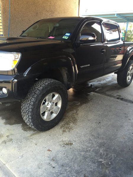

    I had the lift on my truck and yes the front was higher Tacomas sit 1in higher in the rear when stock not 2. I took out the 1in block and put on a 2 looks a whole lot better highly recommend 1.5-2 in for rear lift with a 3in lift

    I agree just finished and it looks higher in front. I'll be swapping out 1" blocks for 1.5" blocks.

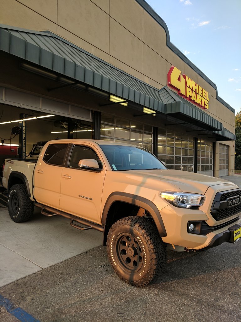

    I went with the procomp nitro kit on my 3rd gen trd and had 4 wheel parts install it. Had really noticable positive camber after, and i was running stoIMG_20170706_193748.jpg ck UCAS. no rubbing whatsoever with 285's and a procomp 17 inch wheel, but i had to take it to a local shop to get it aligned. Now she stands a lot better, drivers side wheel is perfect but the passengers side wheel is just a little off perfect. I took the hit, because to me it was barely noticable.
