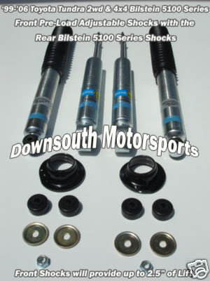

    I have this whole kit for sale 4 shocks and extra 1" blocks for $255 shipped only used for less than 5,000 miles on it. It's a lot better than those blocks lift in the front and better rides...ask anyone they'll tell you.
