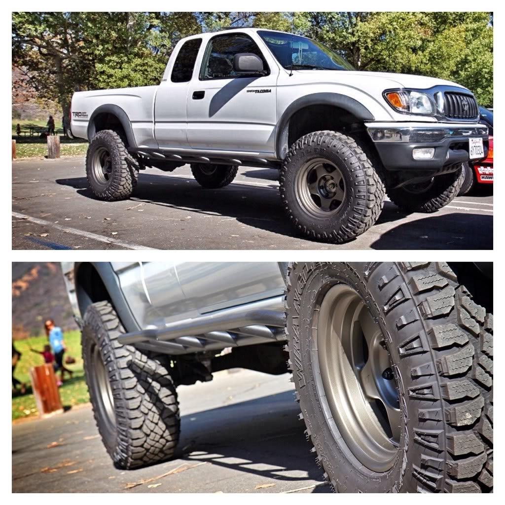

    Should work with hubs

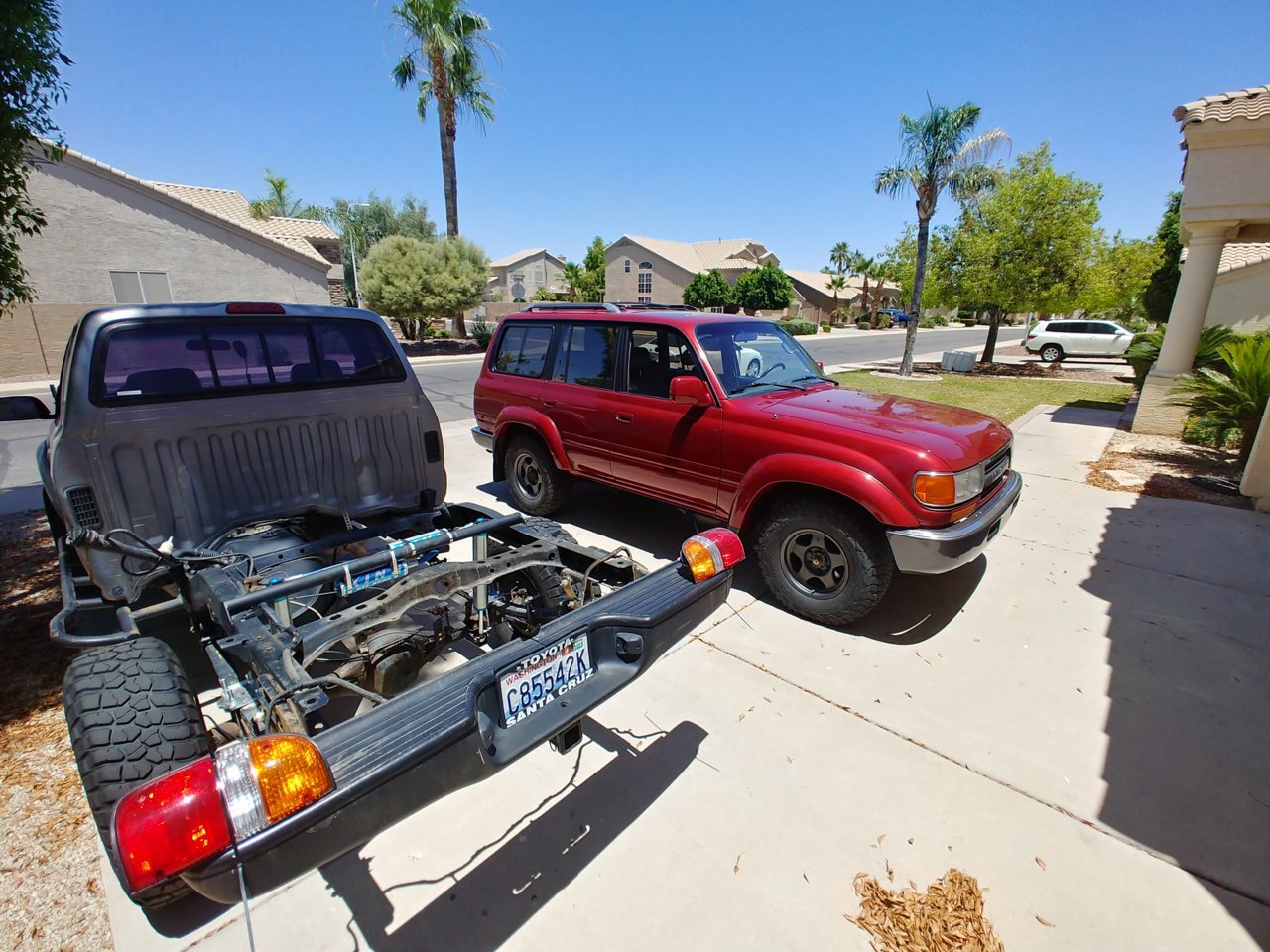

    I had f5s on my truck with manual hubs and on my cruiser with full floaters for a bit. They fit great

    I bet they looked great on the 80, you got a pic at hand?

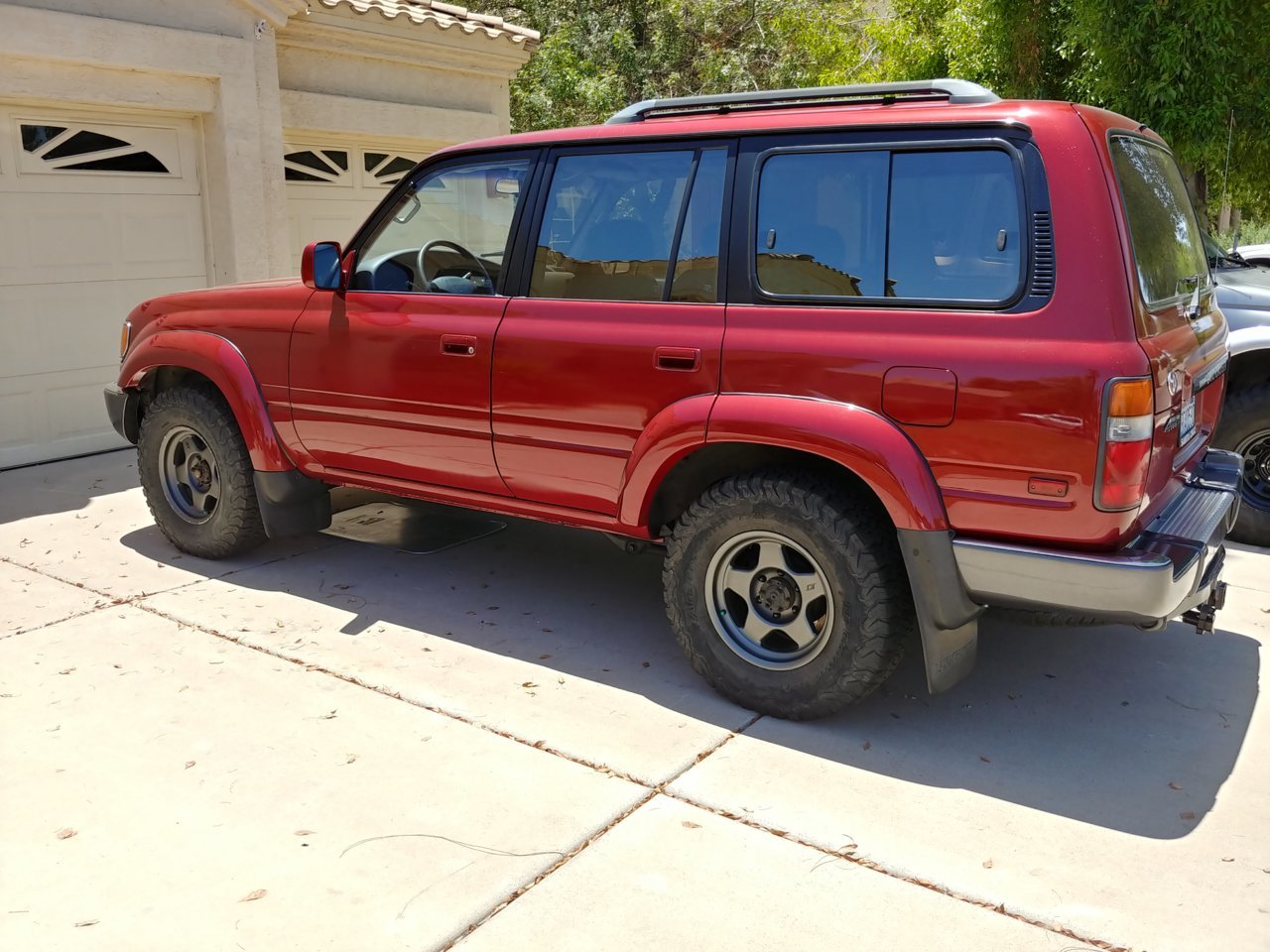

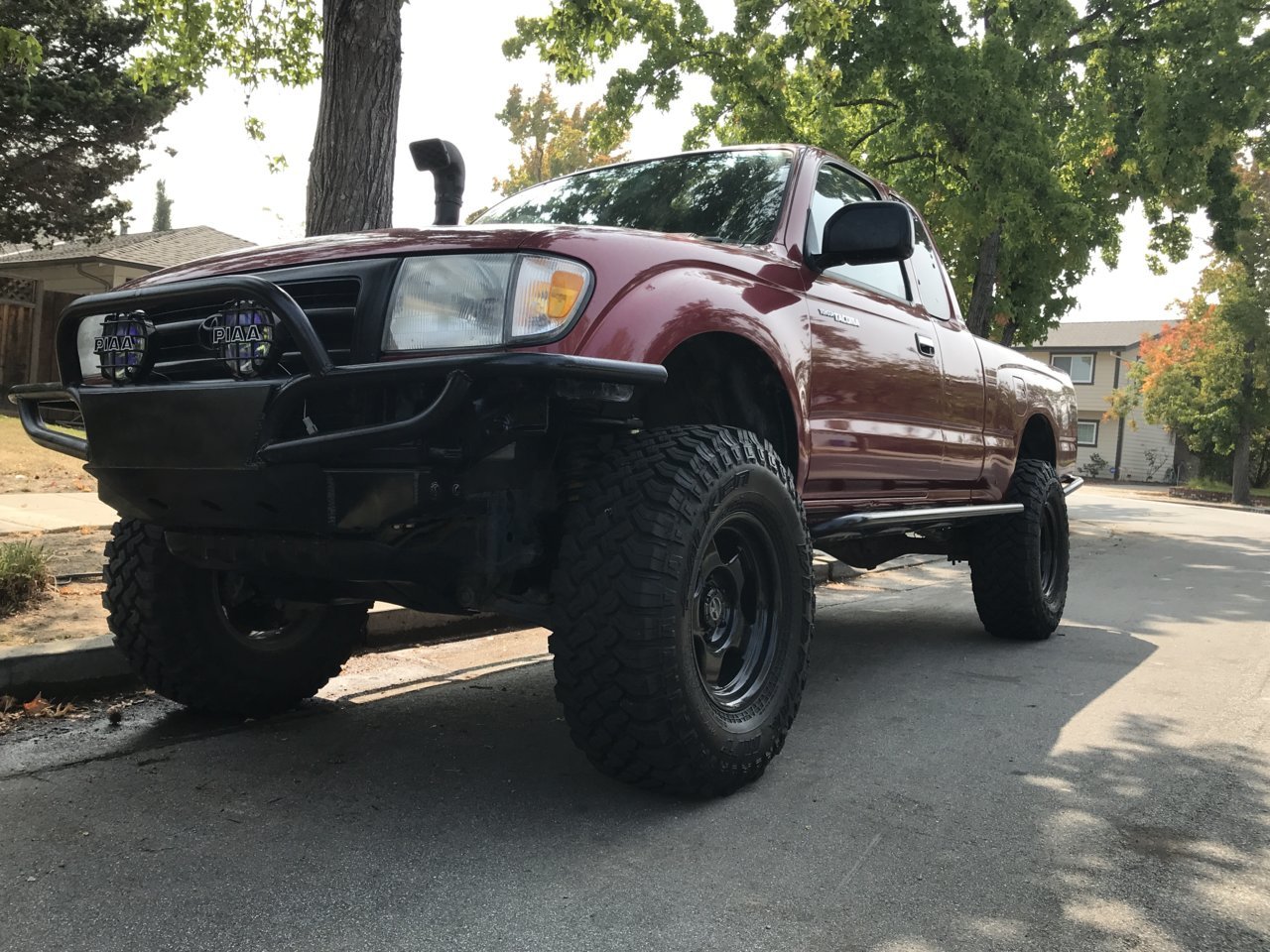

    SCS manual hub fit Gouda

    Our F5 model would be a direct fit, but any of the other wheel models can work as well with a little machining of the center cap lip.
    The 16x8 -25mm is a great size for the 1st gen Tacoma.

    Nice color on wheel to go with that Cruiser. And those are prolly the ONLY aftermarket wheels I'd use as I'll bet the quality of them rivals OEM. Obviously the quality of SCS wheel finish is high but I'll bet the tolerances dimensionally are as close to true as OEM is.

    Mine were 4.5" BS but they offer 3.5"
