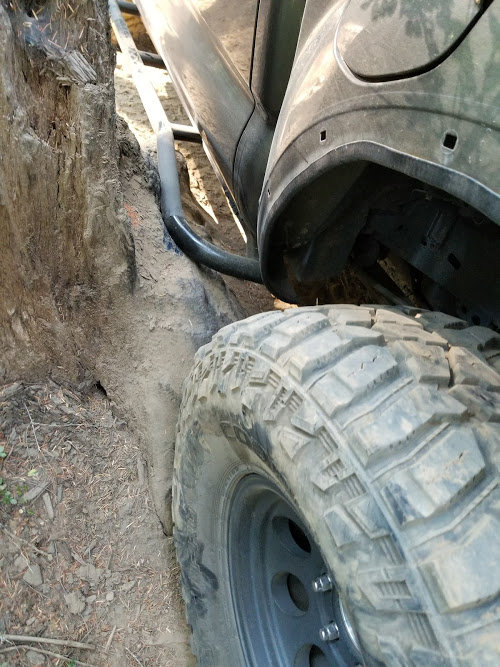

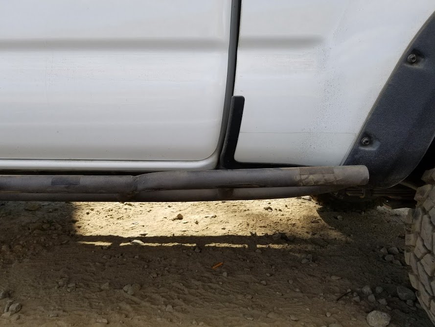

    my steel sliders after a trip lol, couldnt imagine alumn.....ive used my kickouts plenty of times as pivot points

    I can only imagine what my 2.5ton land cruiser would do to alum sliders. That's unloaded too, with gear it's a bit more haha. Be worth a laugh if I didn't think they'd just cause more damage than just hitting the rocks.
